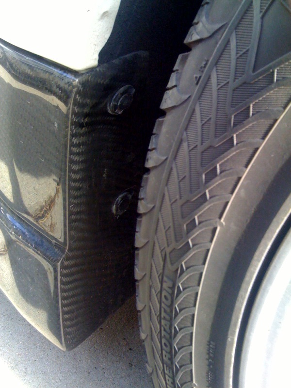

I drilled holes in mine on the top and bottom, then used the stock clips on the outer sides, just used a bit of tape on a few areas, fitment was good on mine.

first picture is with stock clips/rear tire
second is with one of two screws i used on the door jamb, my seibons had an indentaion, which is where i put the screw
third is stock clip/front tire
Only reason that I wouldnt use just tape is because i would be too scared that they would fall off

with a friend, I held it in place while he marked it around the back with a marker, drilled a small hole to see if it lined up right, then made it bigger and put the stock clip through. I know drilling CF, scary but he's put bodykits on befor so I trusted him.
