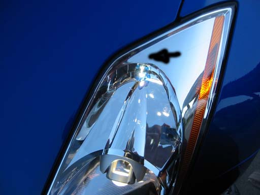

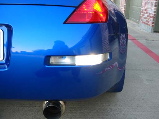

Originally posted by ares
what kind of bulb is that?
I got some of the Superwhite blue bulb 7440 at Pep Boys, had to do some modication, but it was very minor. All my turn signal and back up light are mostly the same type of bulbs. So at night time it is pretty bright! the only thing sucks for the front, it tends to get a little bit hotter than the stock, so on top of the turn signal area has a little discolor affect, but you couldn't tell, until you look very close at it. I wondered if the wattage are too strong with the bulbs that I got for the front?

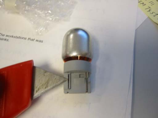

Originally posted by x350Zx
What modification did you have to do to get the front turn signal bulbs to work? Because I also bought some hyperwhites for the front signals, but they only went in halfway.
here is a picture that better explains it.... I mark the line where I cut out the groove to make it fit. Make sure you do that on both sides. And you keep trimming it until you get a nice fit, it would actually click in to the slots.
