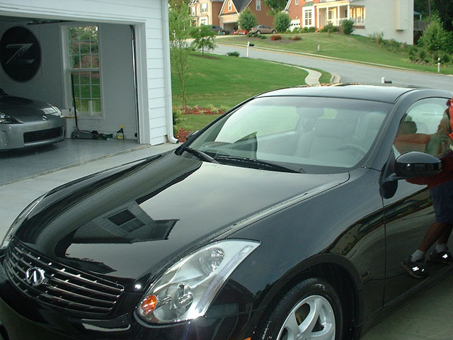

dont have any closer, but this has 3m film, on black. You can see imperfections up close, but not from 2 feet away, and it beats lots of chips.

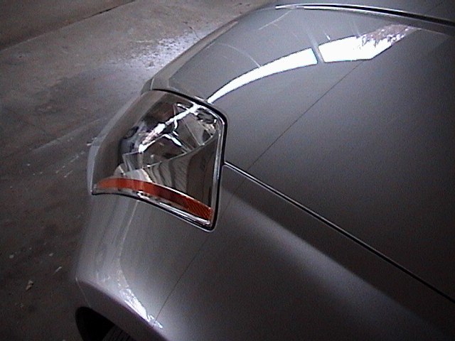

I got the Llumar clear bra on my car. You can see some minor rubs close up but most people can't tell they are there.
I got a good picture of the bra. You can see the line but this was about the only position I could take the picture to make it visible.
Attached Thumbnails Looking for Protection from rock dings-grille-indoors-001.jpg

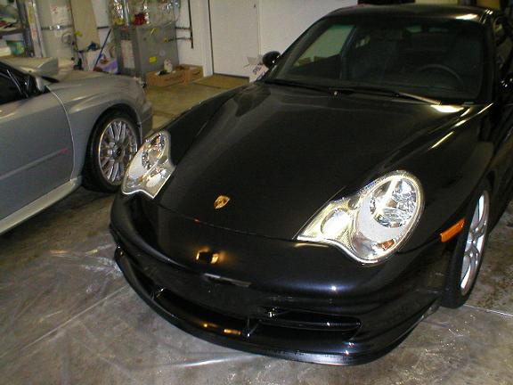

The only real drawbacks we have so far with Llumar is its a bit more expensive and since the SEMA show its been hard to get. We ended up with a good amount before the SEMA show since we are close with a Llumar rep, heres a new GT3 we did recently with Llumar to see what it can do for black

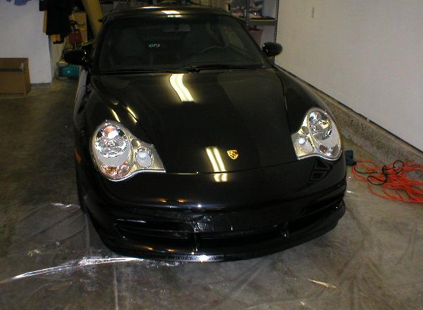

Hey! Whos cool WRX STi is that next to that little black car?...

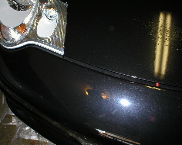

The film is still a bit wet in this pic so it really doesnt do it justice to how smooth it really is, as of now, it is hands down the best choice on very dark colors. If anyone has any other questions about paint protection film feel free to drop us a line!
Jeremy
Invisiguard@sbcglobal.net
