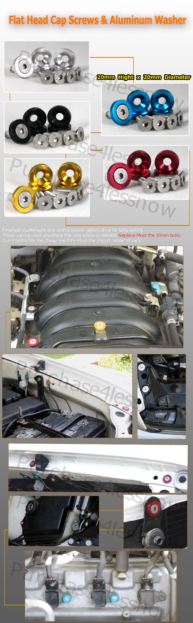

I like the countersunk washer, but they would again need to be a coloured option so you cover all buyers.
You want to appeal to ALL buyers, not just people who prefer a stainless finish as there are not many of them out there (inc myself).
Another example:
If you designed a complete kit for our engine bay like above, i will most certainly make a purchase. However i'd like the ends of the counter sunk washer to be slanted/curved down like your titanium ones:

Those are kinda what I had in mind, but I know of some that are tapered (but not angled). I think that setup looks really nice and I should be able to find a manufacturer with no problem. I see you saw my vision. (That's a hell of a statement by the way)
