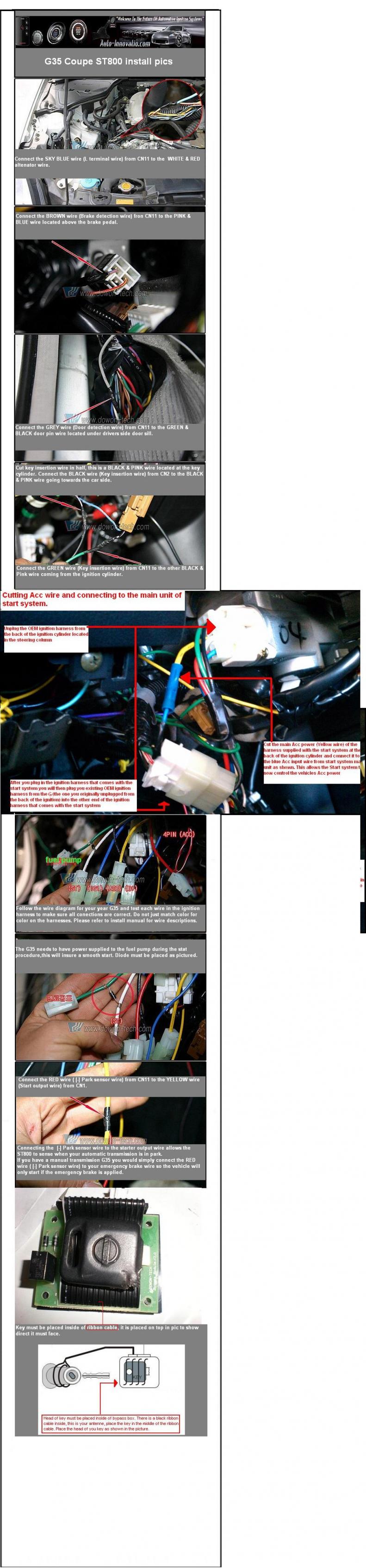

Originally Posted by kevinapex
I have my touch start almost all installed but I do have a few wiring questions.
the red and orange for the park sense signal off the 11 pin go to a 12v? what color?, I have a manual trans.
And the relay for the starter? the output to the starter is what color? off the relay. The instructions are a bit hard to see. Also are we just grounding out the lock sense wire from the 4 pin?
thanks for the help
i'll try to help. Since you have a manual, you only need to hook the red wire to the parking brake wire. i did not use a relay for the starter. I'm not sure what the lock sense wire is, what connector is it on? If it is the grey wire on CN11 you hook that up to your speed sense wire. I'm not sure what it is on a 350z, my was green w/white stripe on my factory radio harness. The next pic is a good diagram from Sean that show's the initial install that may help. It is for a G, but almost everything is the same. If you can't see it shoot me a pm with email. There are also some pics on the autoinnovatio install page.
ST800 Smart System: Keyless push button start, proximity sensing security System!-infiniti-g35-coupe-st800-install-pics.jpg
I love my system, it's been 4 months now, no complaints. I did take the time to solder extend all my wires and run them to my trunk. That was a fun day. Sean was a great help even on the weekends.

Hey man, can you help me out with some instructions on how to install the ST800 on a G35? I saw your link but it's hard to read what it says. I also have a G35
