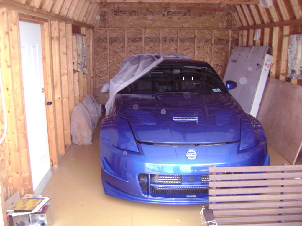

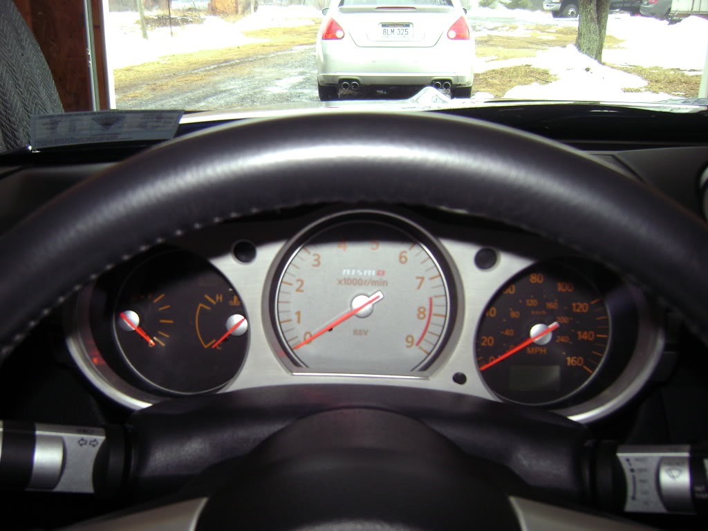

Here you go subdermal, sorry for the poor quality. I have no light in the garage. Also now I wish I would have snapped one with the car running. The Nismo logo in the tach really stands out.
