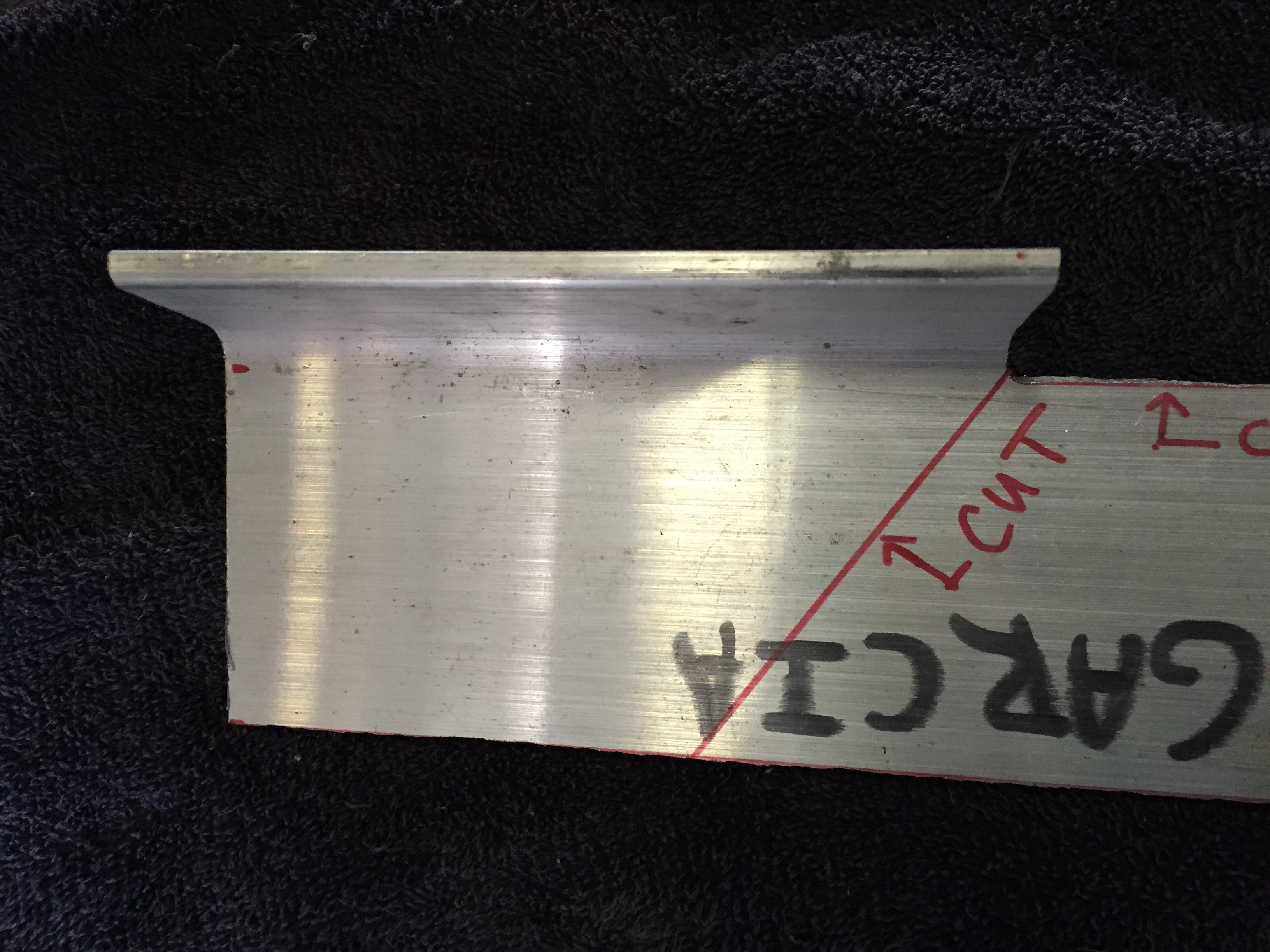

The top plate measurements are 5 3/4
This is for the front tow hook placement.
More pics to follow tomorrow

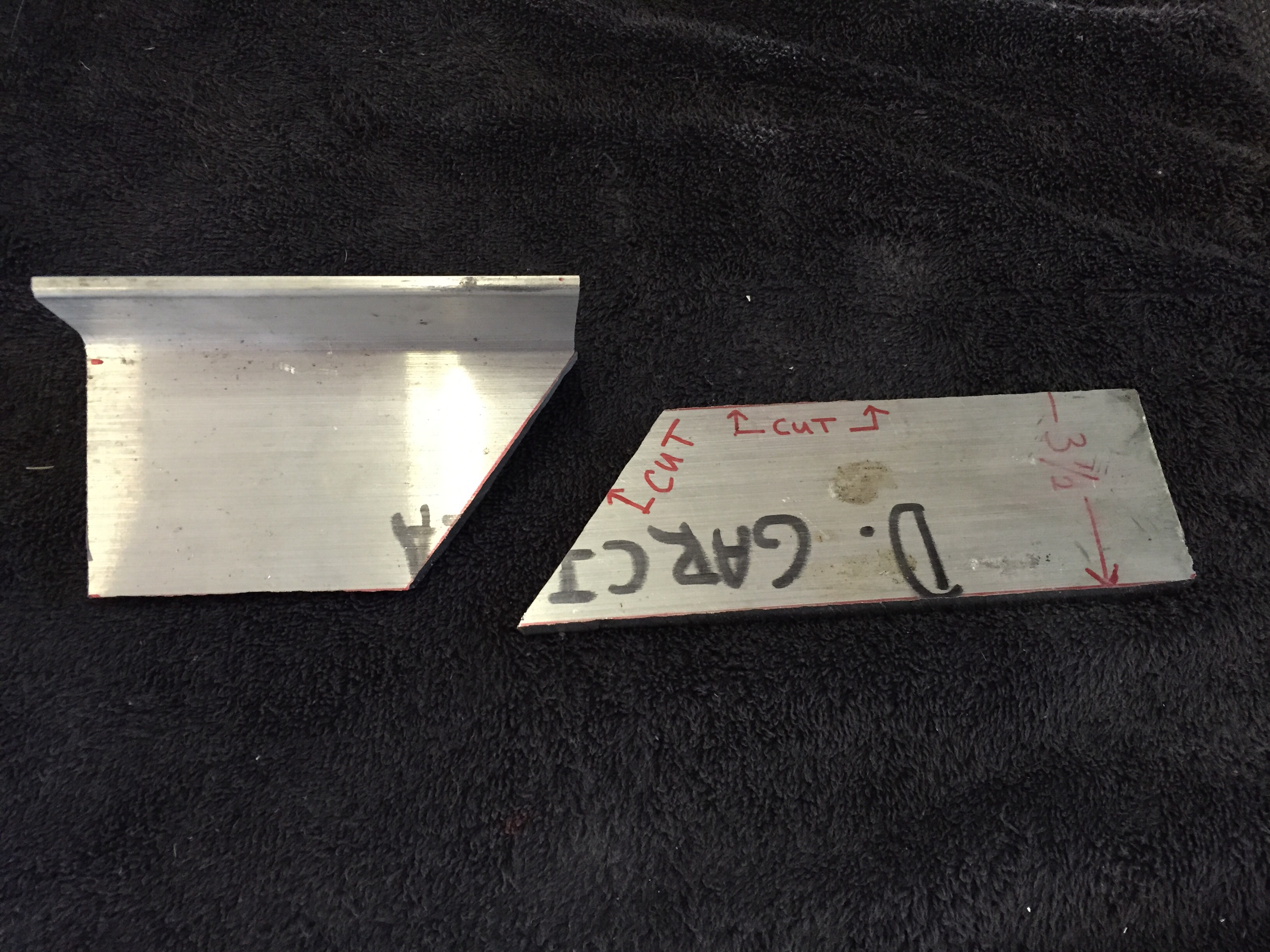

next cut is removing the top portion of the flat plate as marked, do not discard this piece because you will need it for use on top of the crush bar. I also cut off the bottom, I have it marked as 3 1/2 but actually cut it at 3 3/8. this bottom section was cut off only for ease of fitment for there is a diagonal cut required that'll eliminate this long cut.
From a different angle
Another pic
Results of second and third cuts
The mounting bracket is starting to take shape
Different angle

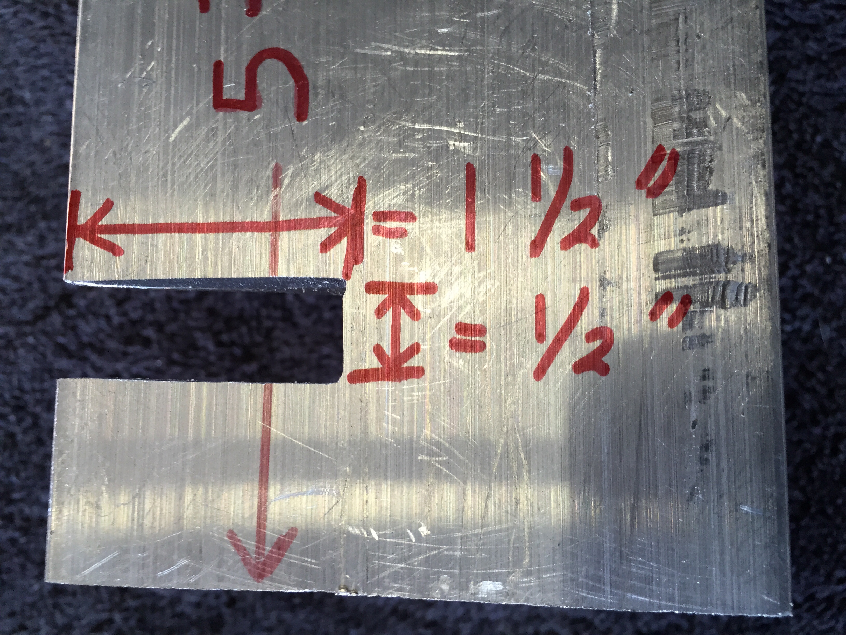

Next is a notch / window cut that will allow the bracket to move closer to the inside edge of the bumper, this may not be necessary if you don't want it too close to the inside edge. I wanted mine as close as possible.
Different angle, cut dimensions are on the plate. This is on the right hand side of the top of the bracket, the cut is also necessary to clear the mount bracket the crush bar.
The sixth cut is marked on the plate and also necessary for the same reasons of the fifth cut. There's a bumper mounting bracket bolt back there that makes contact with the tow hook bracket.
Different angle of the sixth cut on the tow hook mounting bracket.

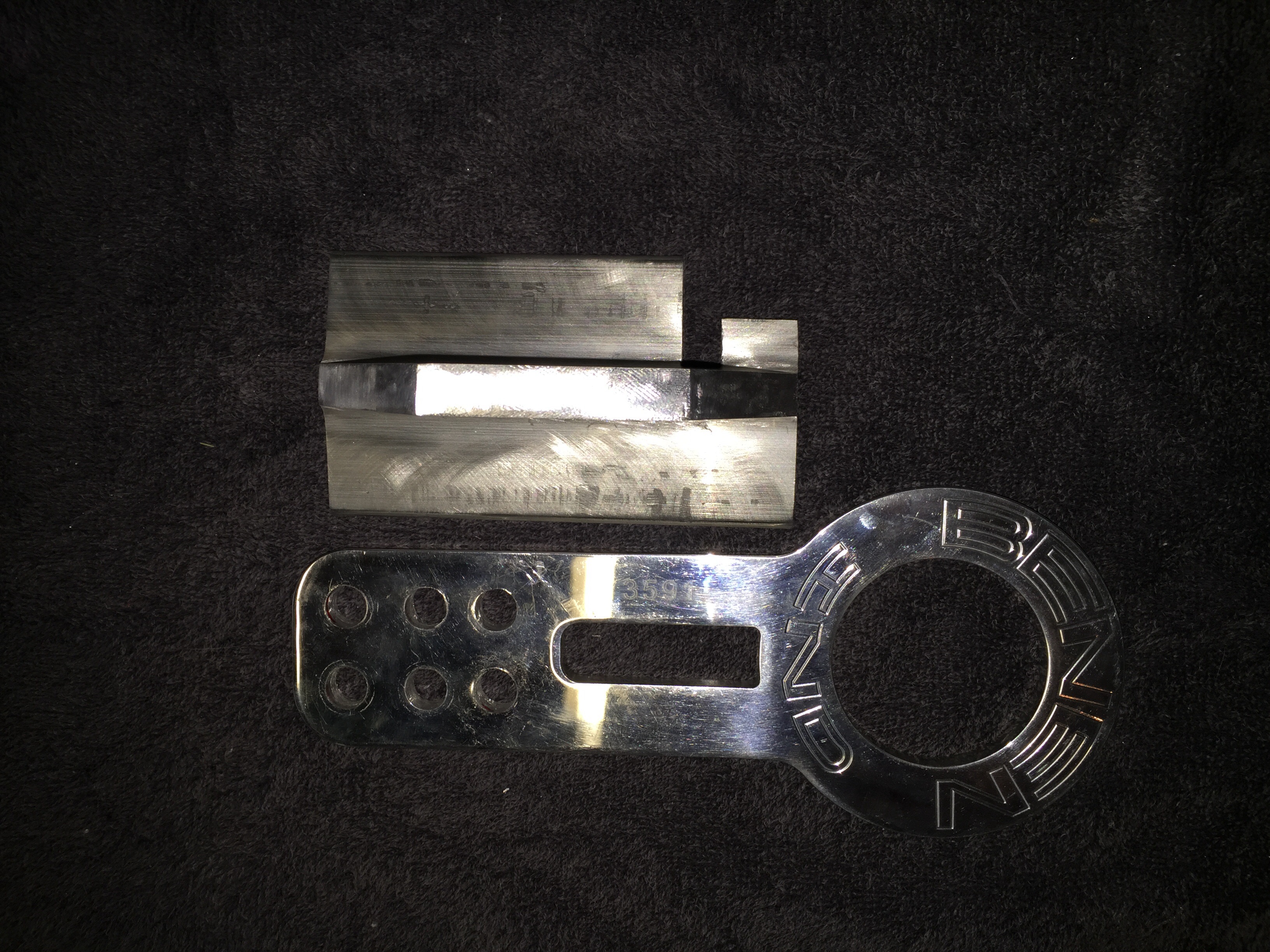

Holes for mounting the tow hook on the bracket and made some marking for the cuts to follow.
A quick test fit pic.
This is what the mounting bracket looked like at the final stage
