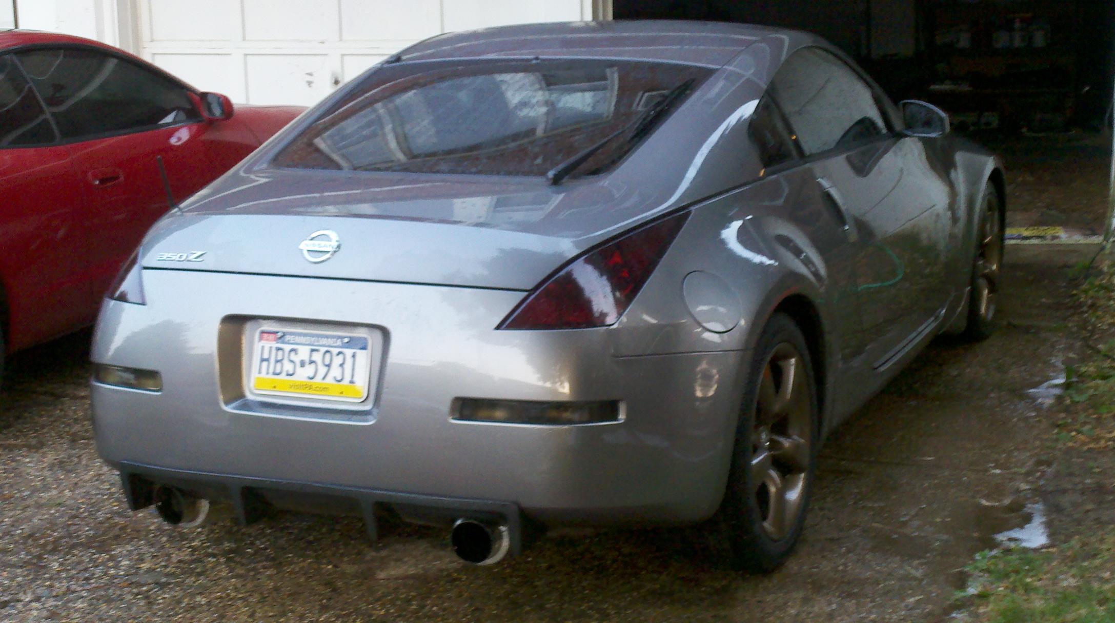

I have this diffuser in carbon fiber. Fits like pewp.
from what i see and experienced (my old one fit like this too) the center screw pulls it up too far because when installing it you push it up to the bumper, which gives a little under pressure, and then when the tape is peeled and stuck on the bumper is under less upward pressure. therefore the sides sag a little and that causes the rest of the diffuser to fit terribly. My advice would be to do all of the taping first, then (if you feel like its needed, i dont honestly) drill the holes and put in the screws so nothing sags. i can post pics of the fitment differences if you want?

this is where i purchased my first one, when they had the first run (i believe they a couple pics of mine?) and the second one was from evo-r... PERSONALLY i would go with HR over evo-r.. my evo-r one didnt fot quite as well and looked like gvulakh's because the shop put it on wrong after an accident...

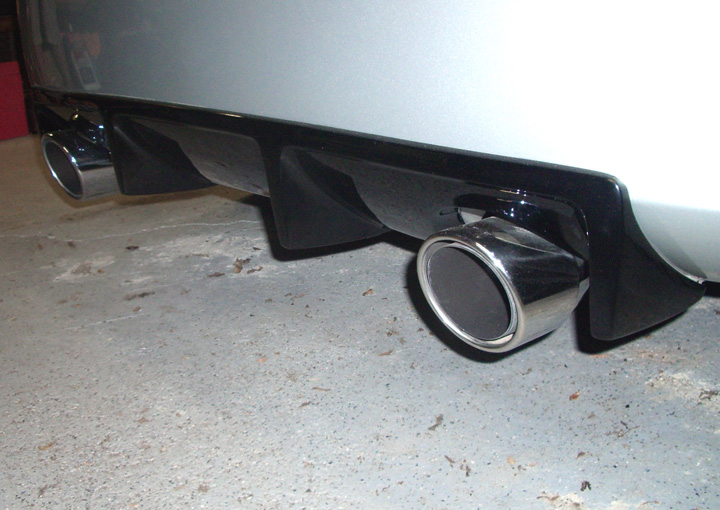

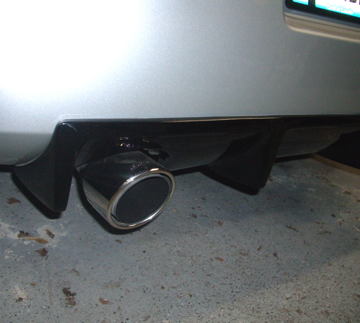

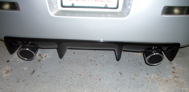

This is the fiberglass one I got from Evo-r. It fits great. I used 3M tape and a screw above each exhaust tip.
Attached Thumbnails question about rear diffuser-imgp1874.jpg   question about rear diffuser-imgp1873.jpg   question about rear diffuser-imgp1872.jpg
