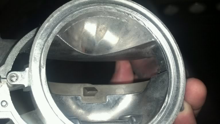

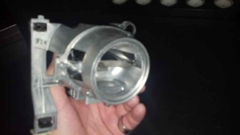

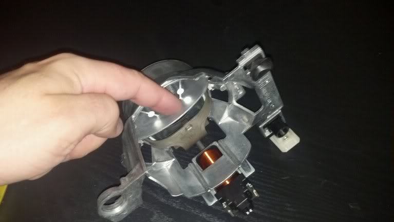

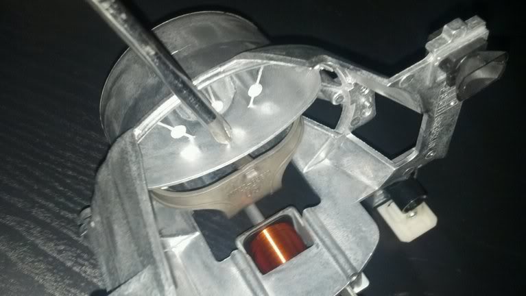

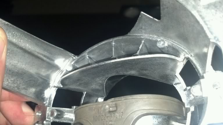

The OP in the other thread opened the projector up as I have already done myself.. and drilled a hole
I took some better photos myself of the area the other OP drilled his hole.. but it puts that led right in the top cut off path of the HID beam....eeesh.
Dunno if i want to obstruct the HID w all the cash ive3 spent getting these bright and high quality.
Plus it would get BOMBARDED by heat... and i am NOT opening these up again.
When these leds go out, thats how i will be leaving them.
Any advice on proper placement or different styles of LED i should be using would be GREATLY appreciated.. and fast please.. i gotta get this moving asap.

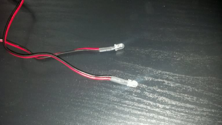

leds i have.. are these bunk or no?

the projector in the proper orientation

top of the projector.. reflector bowl/bulb mount removed..heres where that other OP drilled his LED hole.

the front of the lens bowl, you can see where that LED would just stick right into this cut of... dunno if i want to do that.

The back side of the housing front... again, you can see where drilling that hole thru this would stick it right in the beam pattern.. and I anint gonna do that.. Name:  photobucket-3483-1323227462210.jpg

what is the light angle on the leds

With those LEDs you can sand down the outside, kinda rough them up a bit. It will help diffuse the light more evenly.

the angle im not sure of precisely, but i do know that there is VERY little radial light and that when you stare directly at the tip ( again, no homo haha), its piercingly bright.
I was thinking that perhaps i just had the wrong type of LED.. if theres something better out there.. by all means let me know.. i am NOT known for skimping on ANYTHING, EVER.
thanks for the replies so far..i appreciate it for sure.
also, would dremeling the tip flat help out at all?

I have seen people doing interior LED conversions on various cars where the stock bulbs were incandescent and they had sanded the entire surface of the LED and then filed the top flat in order to get a better dispersion from the LED. I have personally sanded LEDs for better light pattern. If you use a fine grit it is the equivalent to putting a bulb cover on it.
That should be pretty effective.

sanding them will work ive done that as well were did you order them from ? i ordered a crap load of red white and blue and been playing around with them blue and white for me red for my friends cars 1 blue led in the center console cup holders
