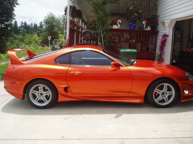

So I have fallen in love with the paint in the picture below...but as it turns out the company that makes it only sells paint for model cars in small quantity. If I took a bottle of the paint to a shop can it be duplicated?

Yes, any quality body shop can match paint using a laser gun. And then mix it on site.
Old Feb 14, 2012 | 05:12 AM
ZS14RR's Avatar
ZS14RR
iTrader: (30)
Posts: 8,235
80% matching is as best any scanner will do. Then its up to the tinter to adjust what ever else it may need.
good luck!
is that color to not a Three stage?

very easily thats lemans sunset w a red pearl coat three stage on top.
Keep it simple and go with a popular and easy to find base color, OEM.
Then have them match a pearl that will be appropriate for the color family.
Be prepared to pay an extreme amount to have the paint work done if its to be done correctly. ALso, any parts you paint and add later will show more as the pearl coats are very directional when it comes to how they are sprayed, reflectivity etc.

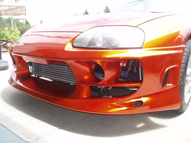

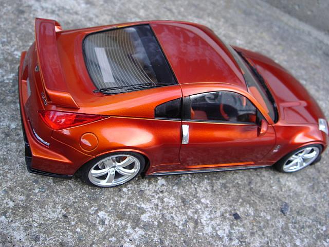

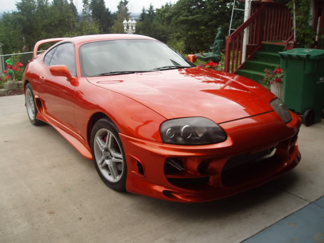

So I think i found on that is close enough and it will most likely end up being a little cheaper as well House Of Kolor Kandy Tangerine with a silver basecoat.
Thoughts?

thats a beautiful color
