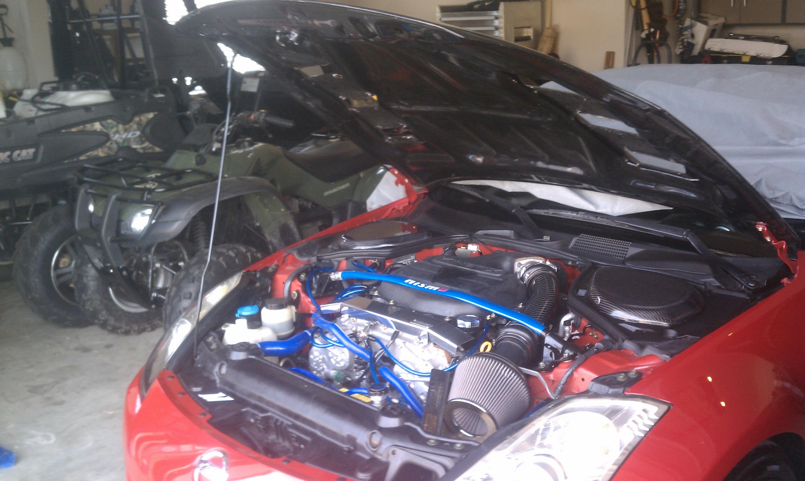

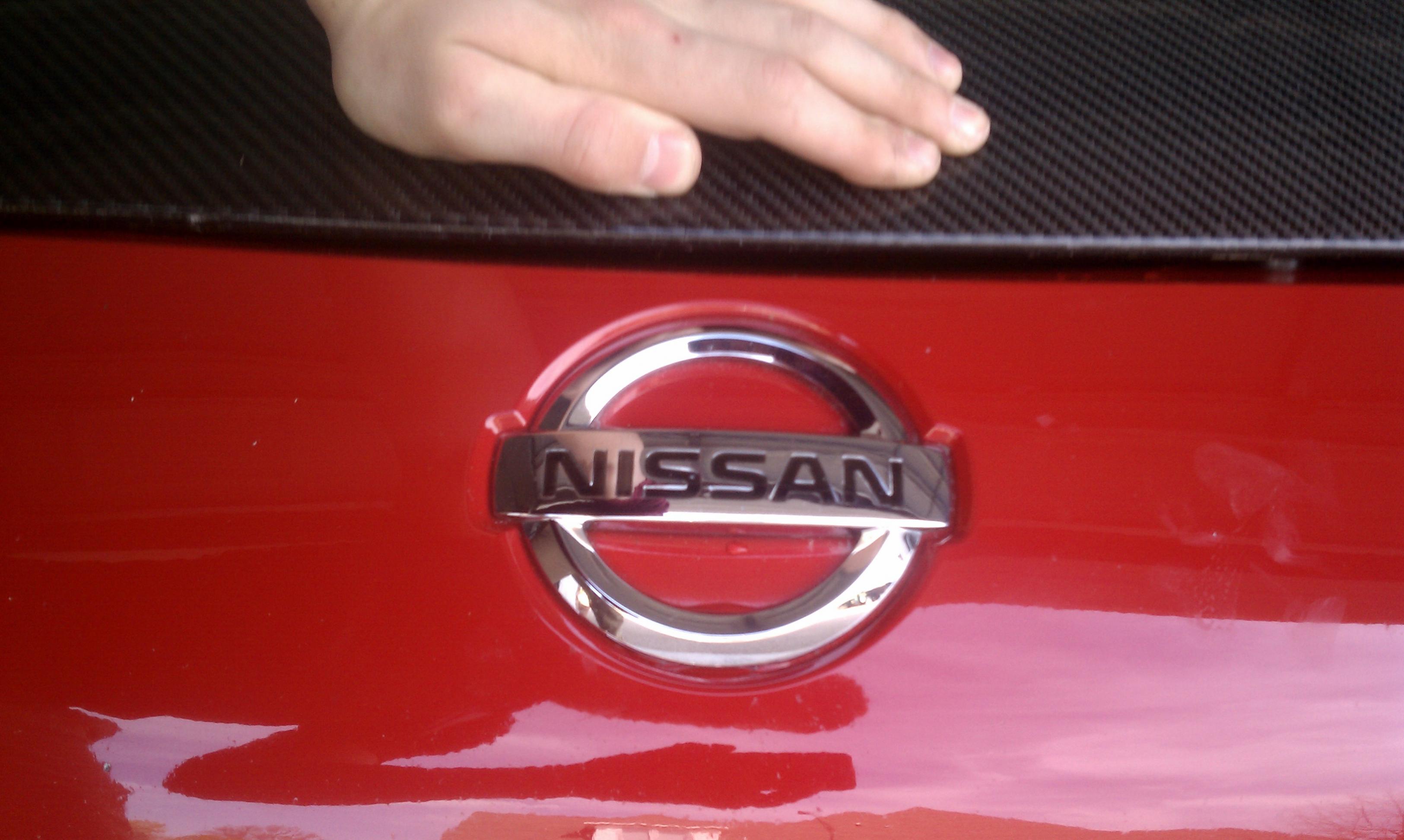

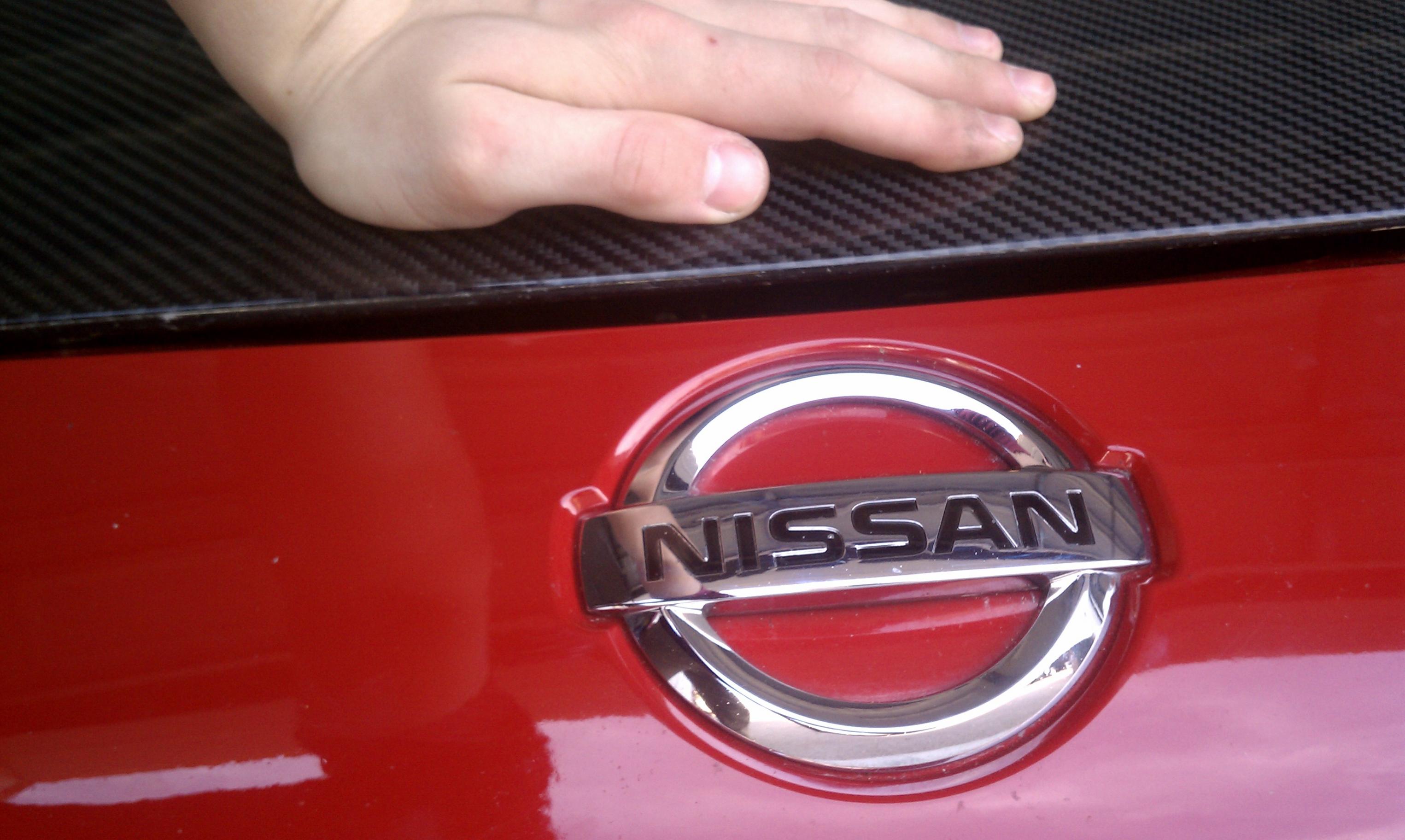

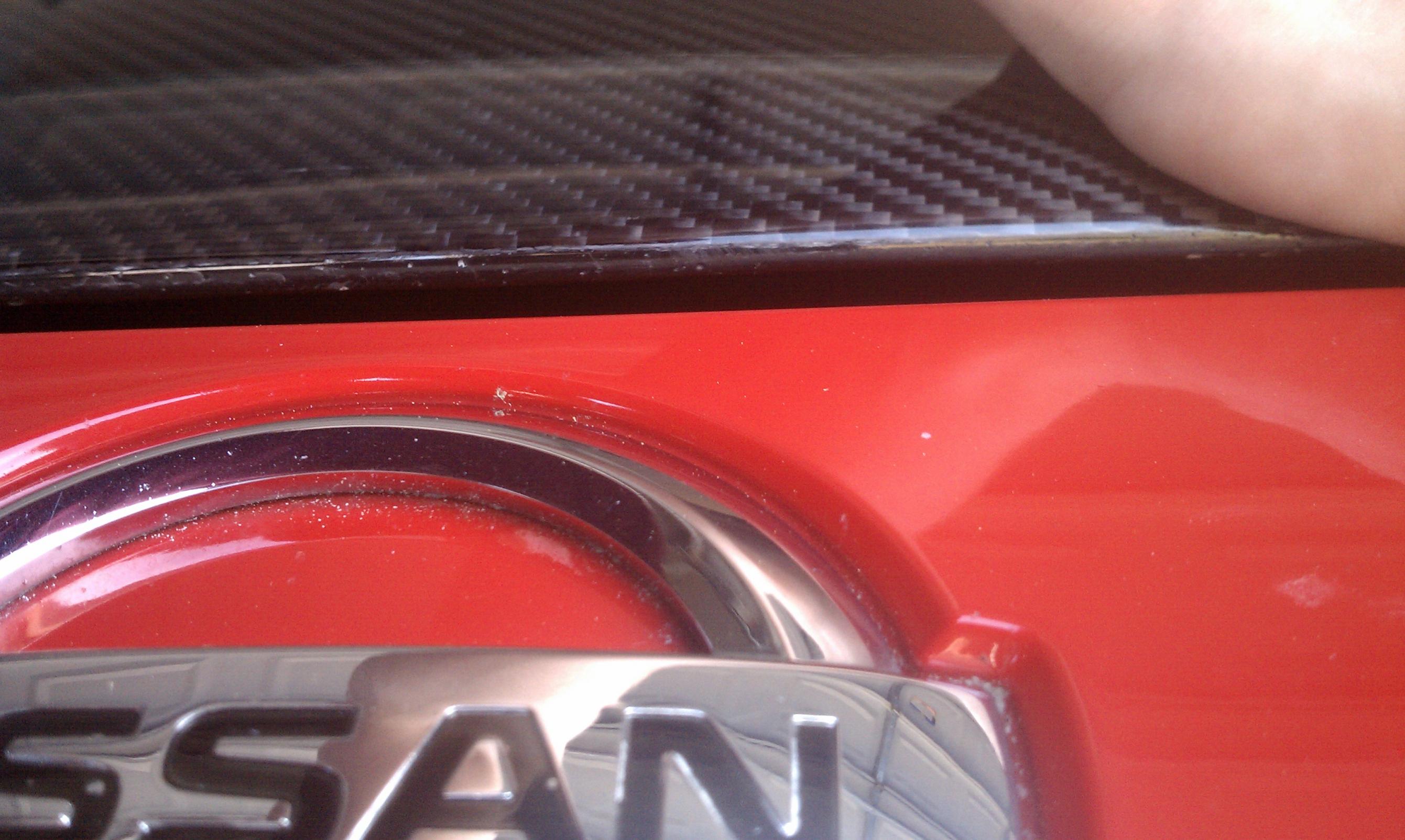

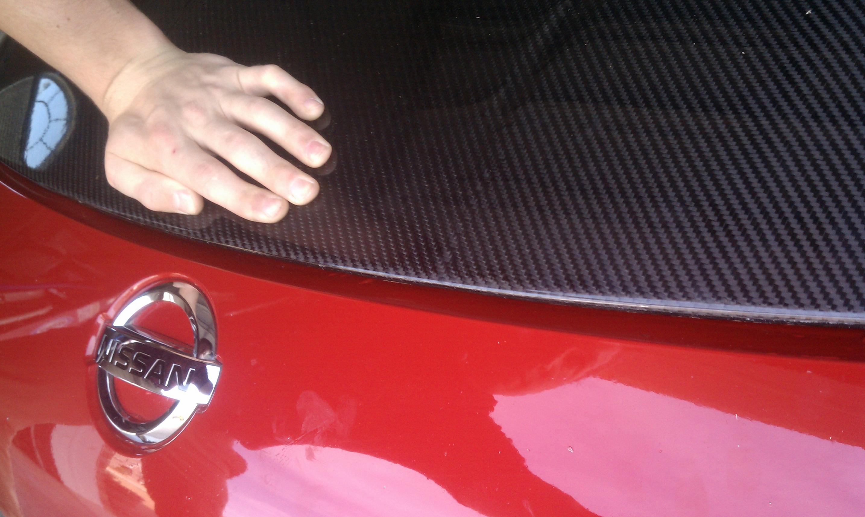

I bought a seibon CF ts hood from a member on here.
a common problem i found with these it that it wont latch all the way
anyways, I did all the latch adjustments and it still would only latch the hook, not the actual latch. I removed the whole latch apparatus and that helped.
Im guessing my only solution is to buy latches that will force it down all the way. but when i force it down with one or two hands at a time, i still seems there is a tiny tiny gap big enough for air to run in under, very thin.
My questions are, I take it i should get aerocatch pins, second, will the pins close the small gap and if not will the gap be detrimental?
let me know what you think please.
If you commenting on this just to say how much you hate seibon or cf hoods, take your comments else where
Attached Thumbnails Seibon CF hood question-imag0126.jpg   Seibon CF hood question-imag0125.jpg   Seibon CF hood question-imag0128.jpg   Seibon CF hood question-imag0130.jpg   Seibon CF hood question-imag0129.jpg

I also forgot to mention I have a kinetix manifold, but i took toothpaste and put it on the hood to see if it was rubbing and no toothpaste was transferred from the hood to plenum

Mine needed 3 spacers on each side for the hood to close properly, but I didn't react fast enough and cracked the hood before putting the spacers on. I do also remember messing with the latch itself... loosening the nuts and trying to move the entire mechanism upwards.
Another thing to remember with these hoods (if this is your first one), is to keep them clean and protected. I parked mine under some trees at work and it rained. It was the first rain in quite a while and the trees dropped a ton of dirt all over my car. The showers were very short, and my car sat out in the sun and dried. When I left for home, my entire car looked brown from all of the dirt.
I lazed out and didn't rinse off the car until the next AM, and to my surprise the dirt was now under the finish of the hood. The rest of the car cleaned up fine. Keeping the car waxed, lessens the visibility of the million dirt spots that are now permanent residents on my hood, but it bugged me so much that I put the stock hood back on and this beast now sits in my garage. Evidently.. the only way to fix this now, is to wet sand off the lacquer, and re-lacquer. I'm not feeling it.
Just an FYI... in case you didn't already know. I obviously didn't and I bought it off of a vender here. I wish that this kind of "care for" information was supplied with the purchase. Good luck with yours.

A gap like that is as good as its going to get w an aftermarket hood, you should see the gap my veilside has.. its crazy.

OP, add spacers to the hinge bolts, foricng it to bend will create small cracks soon enough in the cf hood clear where its flexing.

Get some hood pins and you'll be good.
Post a normal pic of it on the car closed! I wanna see what it'd look like on my redline

Is the hood coming in contact with your strut bar at all?
+1 for the most of the aftermarket hoods fitting that way but I don't think this is as bad as you think it is OP

I dont think it is ....i do have spacers (washers) under the strut so it fits over plenum....the kinetix plenum has a groove in it for the strut bar to fit in...
like i said i put toothpaste on hood and it never transfered to the bar
i think the hoodpins will work but i would hate to cut into the hood and latch it with pins and there still be an opening you know

That crack should be solved by transferring your OEM rubber weather strip over to the CF hood. That will help the gap. Also Most SEibon hoods will hit the battery and fluid covers Check that out. Hope this helps.

Mine rubs on the strut bar and I removed it and it rubs on my plenum now which has a spacer on it. May have to put washers in I guess. Mine does latch thought but I think I put a small stress crack at the front above where it latches from what it looks like. I do have aerocatch pins in as well.

I have the same hood. Try this:
1) Put two thin washers between the hinges and the hood to slightly raise it in the back
2) Make sure that you mount it as far forward in the hinge holes as possible
3) Take off your strut bar
4) Take off your pop charger
5) Take off your plenum
6) Take off your battery and fluids covers
7) Close it and see if it fits any better in the front
If it doesn't fit any better, that's as good as it's going to get.
If it fits/closes better, put the parts back in and:
1) Put toothpaste on the strut bar
2) Put toothpaste on the top edge of your pop charger
3) Put toothpaste on all 4 corners of your plenum
4) Put toothpaste on the corners and center of your covers
5) Close hood and then see if toothpaste is on your hood anywhere (not the other way around because it's hard to line up)
If it hits, you've got to make parts changes or deal with the gap.

get hood pins...
personally i'm super paranoid of the fiberglass latch, i had a buddy's crack and have his hood fly open on the freeway. bad scene right there.

i had to make minor adjustments to my seibon hood by removing the rubber bumpers, and adjusting the strut bar and hood latch height. i also had to push the hood latch back so it would catch and lock correctly. Aerocatch hood pins are a great idea.

looks like im going the aerocatch route just to be safe
