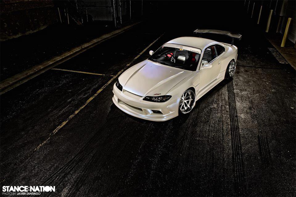

It's going to be painted the same color and I don't know anything about paint but is it possible to have the shop do a different pearl in the ppw paint that would have more hue's of blue in the right light? Kinda like the car in the pic below. If not it was just an idea...

Looks like a standard pearl white. Shops can do all sorts of paint variations so I'm sure if you go the right shop they'll be able to mix exactly what you're looking for. Shop around and ask to see samples of their work.

i think the stock Subaru white pearl has some blue pearl in it also

Pearl paints are a 3 stage paint process. the first coat is the color coat(the white) and then the pearl which is a transparent coat is sprayed on top of the color coat, and then the clear coat is sprayed on top of all that to make it nice and shiny. and yes we can add any color pearl in it. Nissan pearl is more of a bluish yellow, heavier on the yellow. Cadillac has i think pink/blue. i like the Cadillac but at some angles it looks too pink. talk to your paint tech at your body shop and he will help you. just tell him what color pearls your looking to get and what effect you want.
If i ever get enough time to do my own car i would like to do it in the Lambo balloon white, which has a blueish pearl in it.
paint code would be PPG code: 22409
