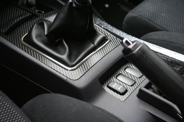

Not sure what you are asking but small pieces are fairly easy. Started wrapping my cars last month, pic of wrapped trim in my X.

Looks good man!
