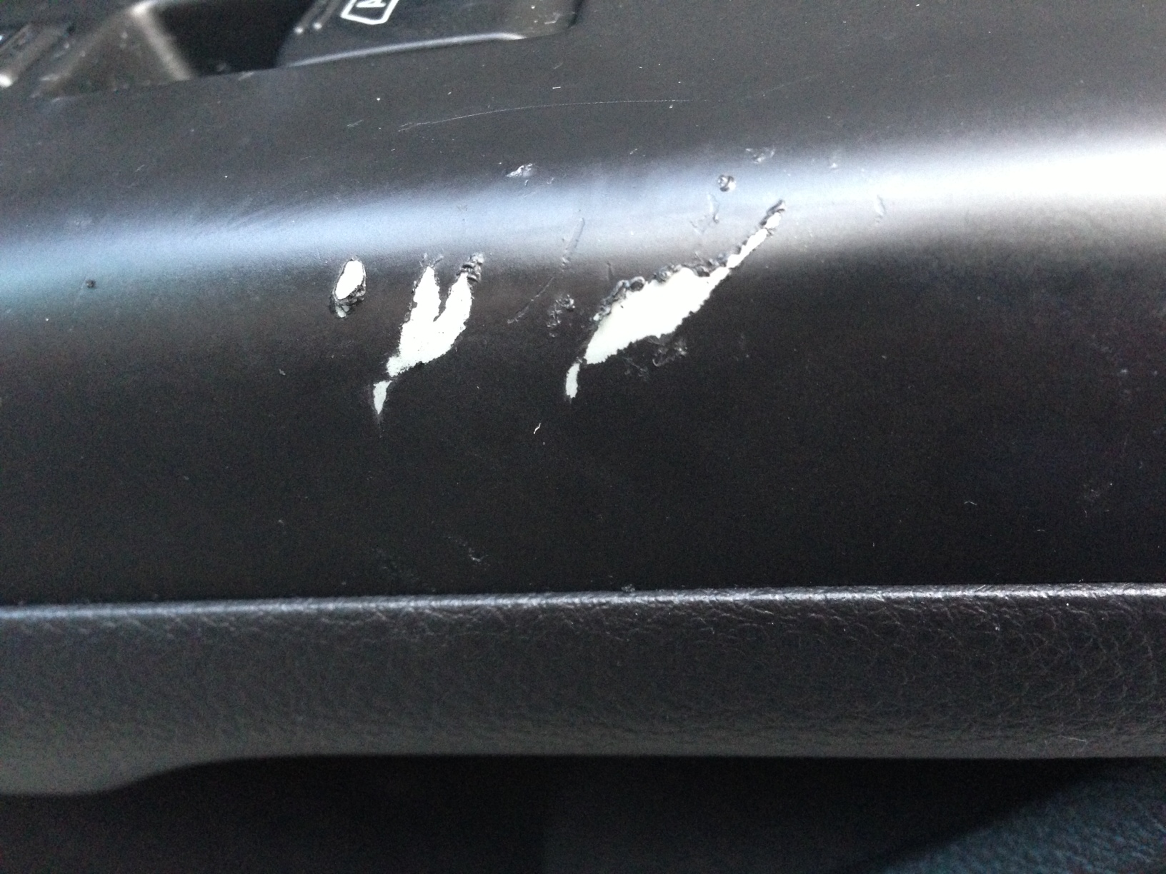

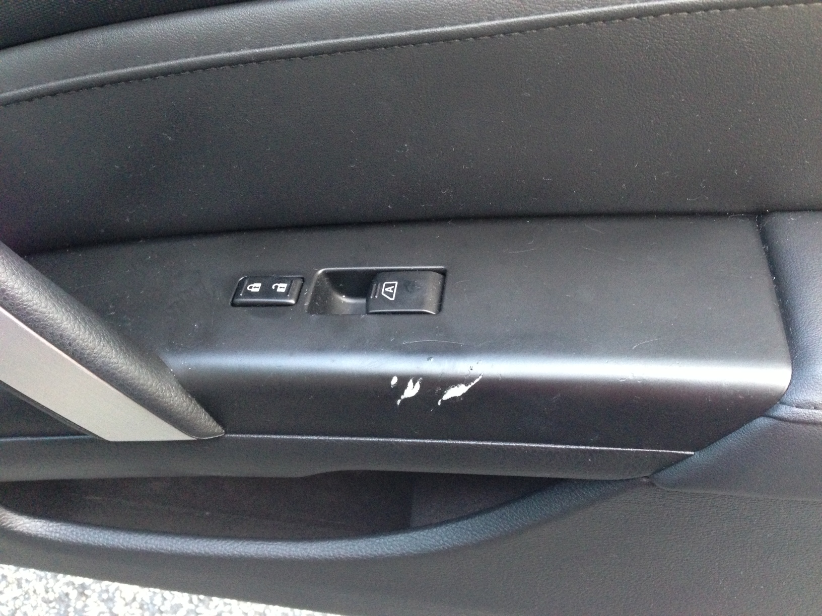

I've had my 350z for about three weeks and i have already scratched it majorly tonight with my laptop bag getting out of the car after work on the door. What do you all think is the easiest way to fix this? I have attached pictures to help better explain.

People sell the passenger window switch housing's all the time in the market place. They're pretty easy to switch out and they're usually sold for around $20-$40. Check it out https://my350z.com/forum/interior-418/

Here's what to do. Remove the plastic piece. Lightly buff out the paint and scratches with 800 grit or so sandpaper. Buy a can of Duplicolor "Black Trim Paint" in a rattle can and mist on a few light coats letting them dry in between. Color is nearly identical and it will hold up better as well. Dont spray it on too heavily otherwise it will craze the rubberized paint and look like fubar.

(found these instructions from another member) To remove it you'll need to remove the aluminum plate on the vertical handle. Do this very carefully with a small flat-head. It's just snapped in place. After you remove that piece, you'll need to remove 2 phillips (or 10mm) screws at the top and bottom of that piece. Then pull the whole handle out of the door. That will give you room to remove the passenger side window switch panel the same way as the driver's side.
You will, of course, need to disconnect the connectors from the switch panels once you've lifted them out of thier place.

You can fix the door(its called door switch cover)by painting it.But,its gonna happen again if you keep doing stupid things like you did with your lap to bag.
Also,not everyone has the expertise to properly paint this part.A lousy
DIY'er will wind up with a greater mess!
What I would do is one of two things.Lets face it,some of use,due to our everyday
life,take things in&out of our cars.You need something more durable.I'd buy CF
covers to go over the switch panels.The Z STORE sells e'm.They are covered with a
pretty durable clearcoat.Look good too.Secondly,its a shame that the sides are
scratched.There are dash kit covers (CF too)that will cover the top surface.These
have a very tough poly coat.Very hard to scratch.You'd have to refinish the sides though as these cover just the top.You can buy the parts from CARID.com.

Another option is a vinyl wrap like dinoc. Of course you'd have to wrap both sides, but it's inexpensive and has a nice finish.

I used some matte black vinyl wrap and it's pretty close to the factory finish. More durable for sure

You also have to pull the arm rest piece first before pulling the switch cover.
The screws you remove as stated above are not the same length. Make sure you do not interchange them when you put them back

Go to the craft department in the local Walmart, and buy a little jar of flat black acrylic paint and a small artist's brush with a flat end. Total cost is less than $2.
Remove any loose flakes, and clean the part. Carefully apply the paint around the switches and up to the surrounding surfaces, then paint the rest. Wash the brush with warm water.
The paint dries in a short time, and it usually doesn't show the brush strokes. It's a pretty close match for the original, and you can touch it up easily when needed.
For the cost and time involved, it's worth a try before undertaking removing the part for replacement or repainting with something that doesn't match nearly as well.
