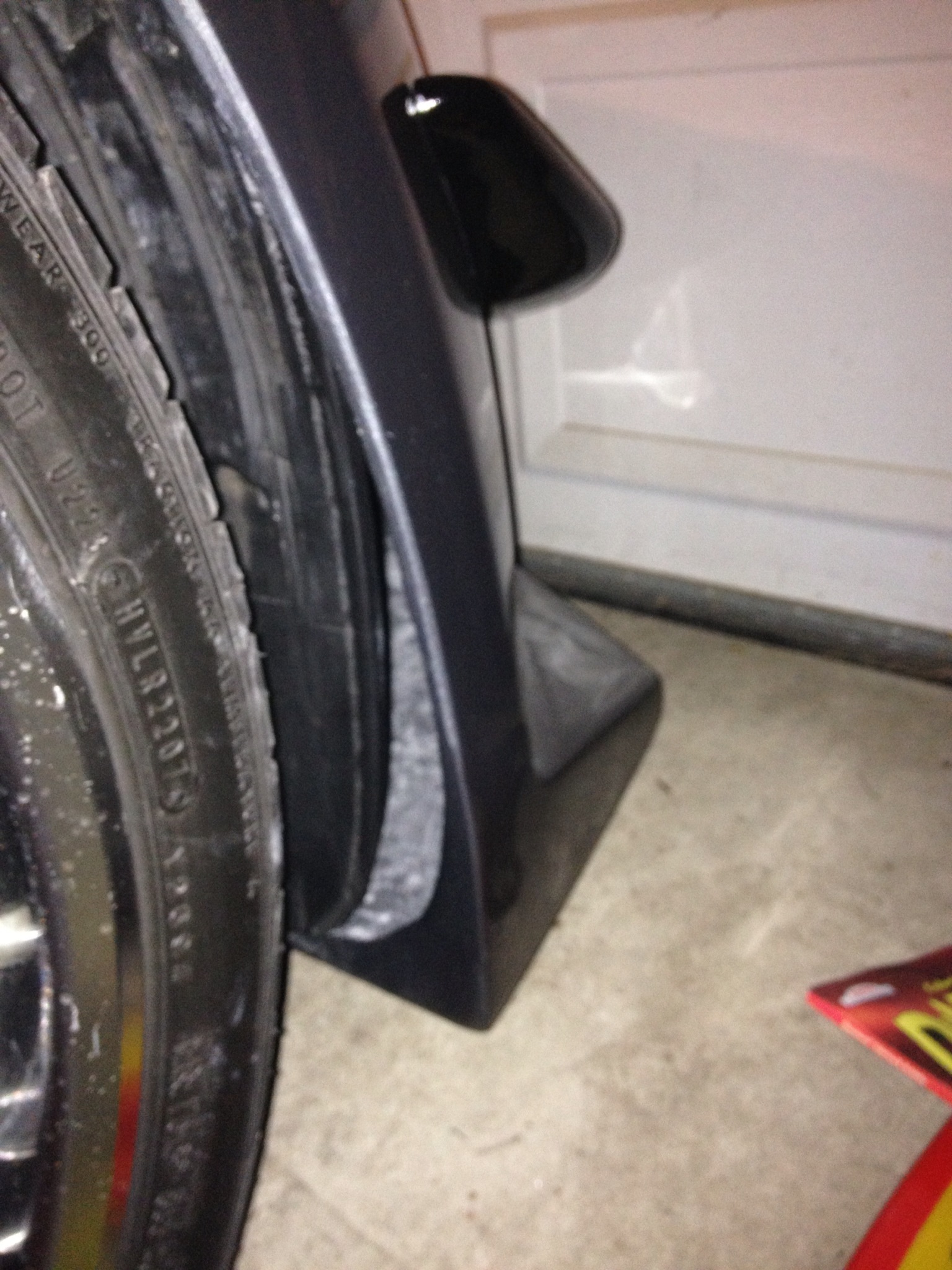

Since everyone's definition of good fitment can b different, here is a pic of my wheel well liners. Do you guys look like this or better?

mine looks oem to be honest lol
You need 06+ fender liners with the NISMO V2 bumper. Yours are the wrong ones for the bumper.

i should have mentioned that my car is a 2005 model.
@marrocco - would the same apply to the undershroud? thanks.

No, should be fine from what I have read.
Here's a link for some inexpensive ones.
http://www.rockauto.com/catalog/x,ca...5,parttype,823

Yeah, you def need the '06 fender liner. It'll be a little longer so you can tuck it right into the bumper.

I have the Shine version and the undershroud matched up perfectly with the new nose, although I replaced it with a ZSpeed aluminum shroud a little later anyway. As to the fender liners, get '06 - '08 liners if you are concerned about the slight space that will be open in your front wheel wells (which no one is likely to ever notice anyway unless you point it out).
