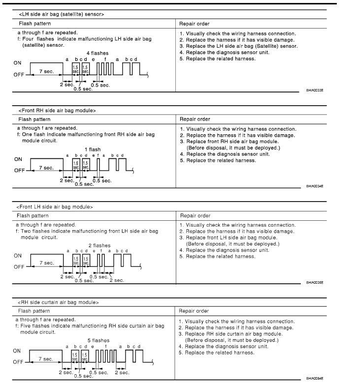

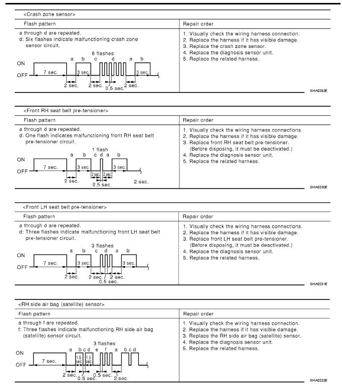

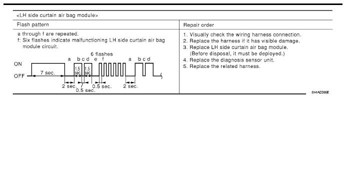

Originally Posted by MrKaira
like how to read which airbag is malfunctioning. Do you have a link to where I can find that?
if you have the service man. its like on page SRS-32.
else here ya go- (note this is off the 03 manual)
Attached Thumbnails How do i disable driverseat air bag?-srs1.jpg   How do i disable driverseat air bag?-srs2.jpg   How do i disable driverseat air bag?-srs3.jpg   How do i disable driverseat air bag?-srs4.jpg
