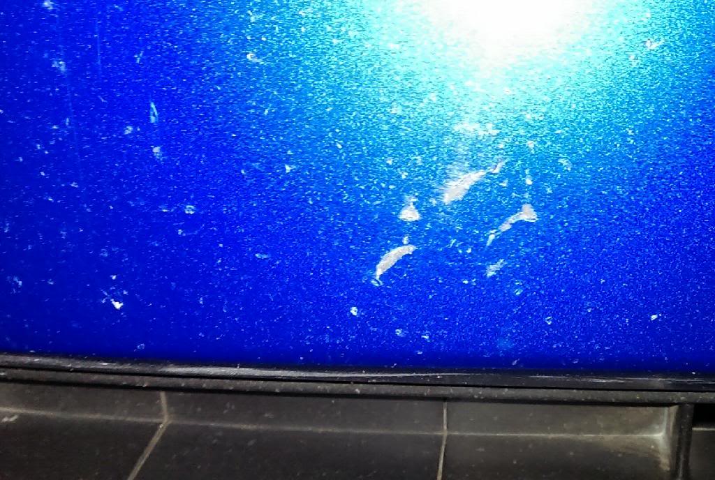

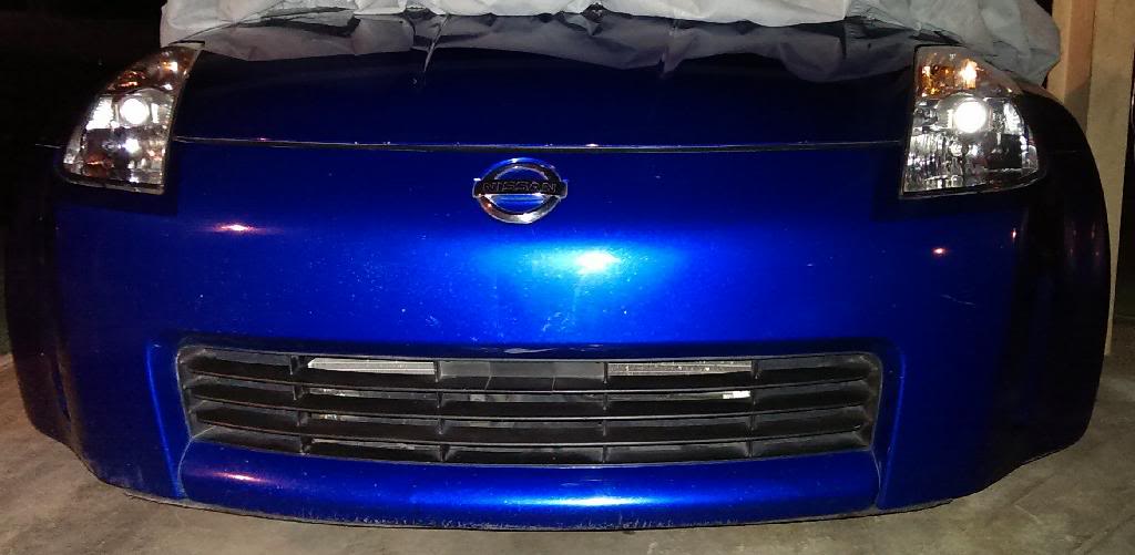

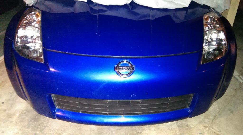

Pics -
Old Mar 30, 2014 | 07:47 PM
dcains's Avatar
dcains
Joined: Aug 2009
Posts: 5,126
Likes: 436
From: Lutz, FL
That's pretty rough. If you cab find a good color match, you get the proper brushes (no toothpicks, or the brush in the cap of the paint bottle), you thin the paint (so you can put on multiple super-thin coats without building up a big blob), and you're very patient, it might turn out OK. You might even try buying aerosol paint, since it's already water-thin, and apply with a good-quality natural sable brush.
