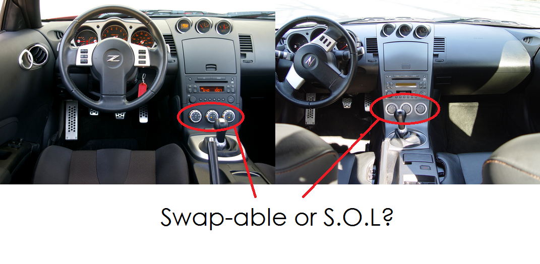

I've searched.
Will gen1 HVAC controls line up with gen2 console and will the harness match?
I hate the aluminum trim and I think it's chintzy.
Has anyone swatched 06+ HVACs into 03-05 or vice versa?

They only work with it's matching control unit, that being said,I don't know if the knows them selves will fit in the newer style console. You could swap the whole waterfall, that will work for sure.

You need to swap the whole center console & the unified meter ( white box connected to the HVAC )

Having swapped the updated waterfall and HVAC controls from an '06 to my pre-order '03 Z several years ago, I can confirm this swap will work. But you'll need to not only switch the IP, you'll need the padded side panels, headunit and white control box. Otherwise, it won't line up or function correctly.
