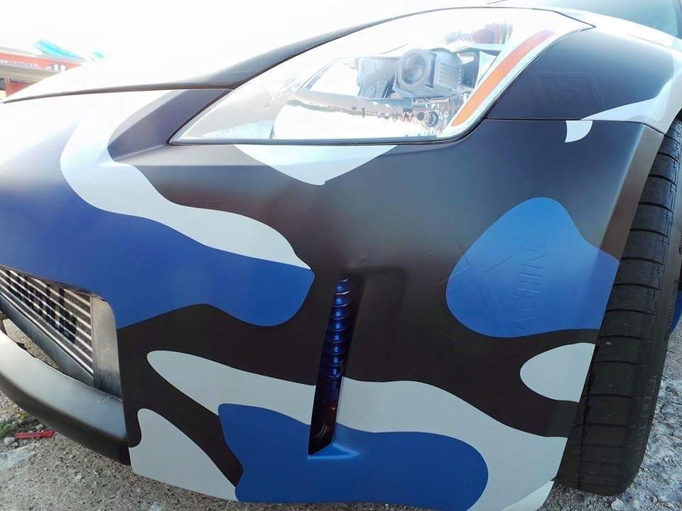

I had my Z wrapped unfortunately I don't have a close up of the roof. But I had my roof wrapped in matte black. They didn't have to take anything off to do so. If the wrapper is experienced you shouldn't have a problem. The seals, will be nice And clean they have specific tools to do so. But I had mine done at kryptonite designs here in dallas tx.

Did you wrap over your X stickers by left headlight or is this total bs?

if kenzi or kenzy... however you spell it... did it you did not get a quality job..... seen her work first hand

I see several flaws in the black vinyl of the front bumper in the 2nd to last pic. A quality wrap should look as good as paint. I'd worry about scratches in the paint from trimming especially if the installer is not detail oriented and its at a shop that just wants to rush your car out to start the next in line.
we saw the same thing, the G37 that i saw she did was horrible, edges not wrapped, peeling in various places etc. when i asked the guy how long he had it on he said like 4 months, i was expecting him to say a couple years
Not sure what you mean total bs????
My car is wrapped in blue camo, lol and the "x" sticker is actually an NTX speed and machine shop decal, they are the ones that built my Z.
To the guy criticizing her job, she did really well. I'm pleased with it, 100%. in her defence a racoon tried to make a nest in my car specifically the front bumper. I have scratches and dents and chew marks going through parts of it. So she had a little bit of a task to deal with. She offered to sand it down free of charge, I said "no thank you". I'm an not one for waiting. It took her 2 days to wrap it and I have no bubbles or tears or anything. So I'll wait for your reply and if you can do better for me I'll let your cash and your time speak for you?
