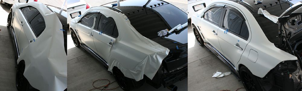

Wrapped my black Evo X white 2 years ago. My black 350z can also be seen covered in Hexis white, was done around 2012. It's wrapped in blue now.
Originally Posted by NFAC
I've used 3D and I wrapped my roof with 4D. It was done 6 months ago and it's still holding up well. It does tack up super easy making it a royal pain in the *** to work with. I cannot comment on anything else Mr.Sparco said because none of the other stuff has happened. I can say this though... I used two different types of Cheap China 3D vinyl.
Trust me when I say 3m is the Volk of vinyl wraps. I've wrapped cars in the double digits now, a couple of them from this forum.
I do not do this for a living but have wrapped 5 of my own cars as well. The adhesive on the cheap stuff will separate from the vinyl from re-positioning, and is more likely to leave residue once you remove it. The 350z roof is one of the easiest panels to wrap so you may not have experienced any of the separation. Complete a seamless non overlapping bumper wrap with the cheap stuff then come back and report.
