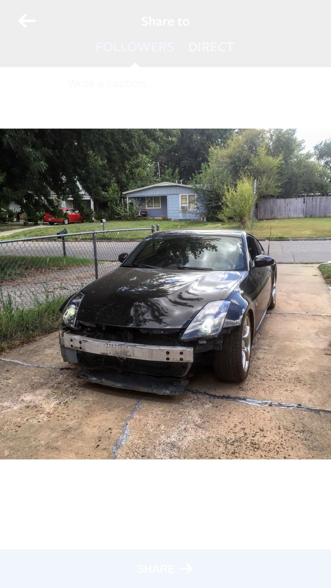

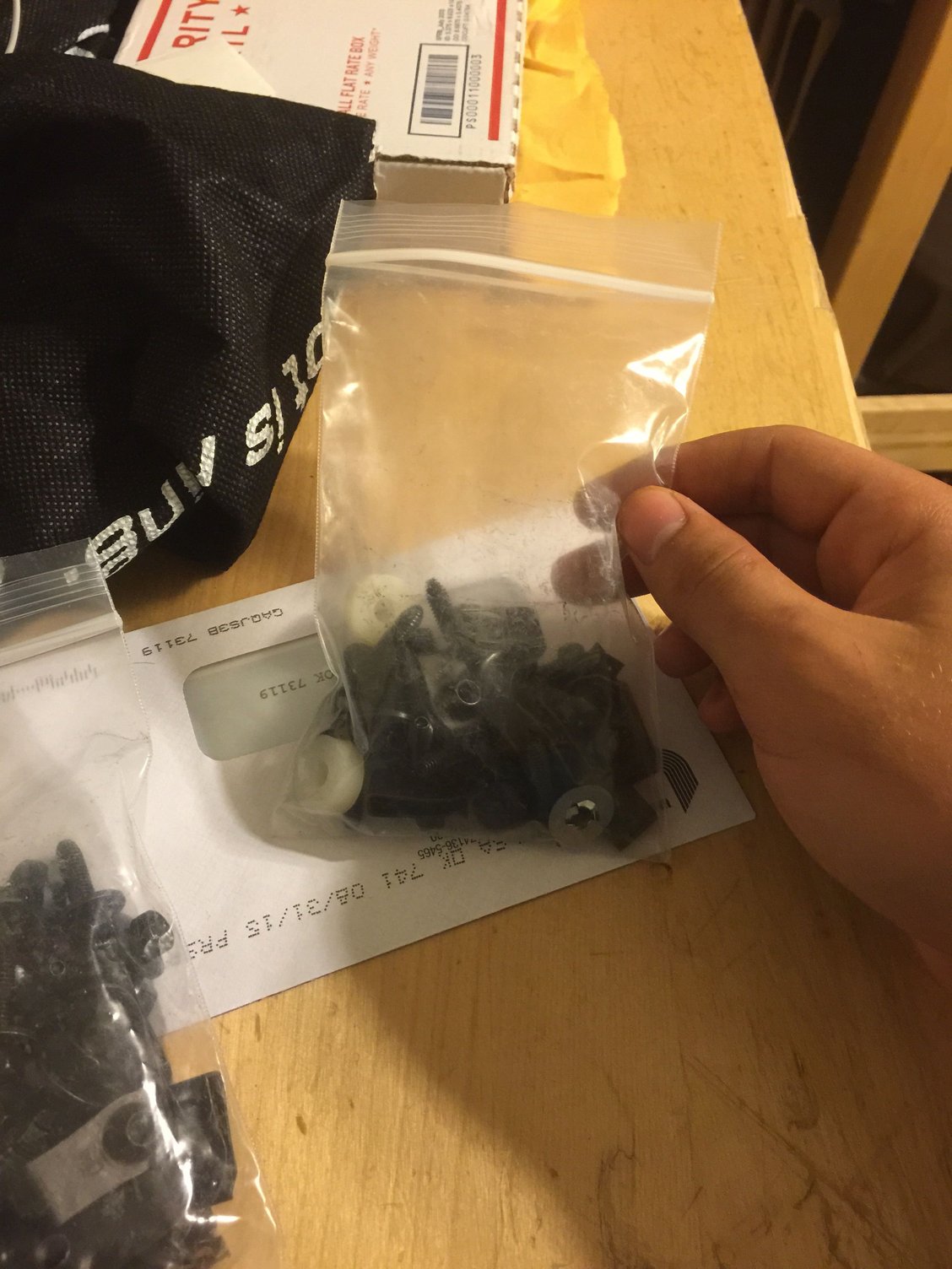

I'm going to install my new nismo v3 bumper on my 350z next week and I want to do it just right. I tried finding a DIY for it but no luck. I have the bumper itself, the aluminum undertray, and the extensions, all from ZSpeed by the way. My main concern is what location under the car is the best to set the two jack stands for this installation. I'm 18 years old and this is going to be my first aftermarket front bumper install so I want to do it as safe as possible and correctly so sorry if I sound dumb. The hardware provided doesn't specify what bolts are for what, does anybody know? (again, sorry if I sound dumb) I would like to hear from people who have done this before and would like to pass information and/or tips to me. Here's how my Z sits right now.
Old Sep 5, 2015 | 03:11 PM
StevSam's Avatar
StevSam
Joined: Feb 2011
Posts: 330
Likes: 65
From: California
Hello and welcome!!
https://my350z.com/forum/maintenance...ng-points.html
This thread has a picture of jacking points.
That's good your using jack stands, +1 for safety.
I usually do one side at a time when putting the jack stands on. Since you're only doing the bumper, just the front two stands will be good enough for this task.
Post pictures of the finished product!!
Old Sep 5, 2015 | 05:40 PM
dkmura's Avatar
dkmura
General & DIY Moderator
iTrader: (64)
Posts: 8,625
Likes: 1,394
From: Aurora, Colorado
The 10 mm bolts, clips and plastic fasteners are needed to put the V3 bumper, extension and bottom tray together. Lay out all the pieces and match up the hardware needed BEFORE you start putting it together. Use the two front jack stand placement points and TAKE YOUR TIME. Think your way through the installation and realize that all these parts are built for a precise fit. If a bracket or hole doesn't line up, it's probably due to a misalignment on your part. Take it off and start again.
