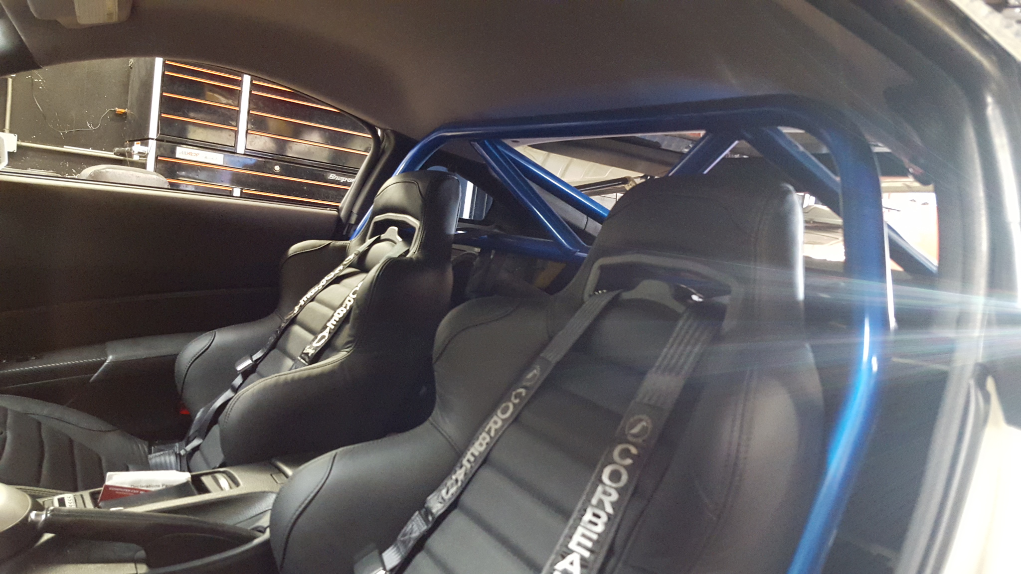

Agree with all...had mine cutom built for my show car as well...bars will be closed cell covered before I drive. Rear stock strut bar will be cut out and a new chrome moly one installed...speaker box comes out and dual NOS bottles mounted on a gold covered AL base.
Like me, the OP may be trying to blend race car looks with show car quality..not many done that way..its usually just speakers or NOS in the trunk with stock strut bar.
