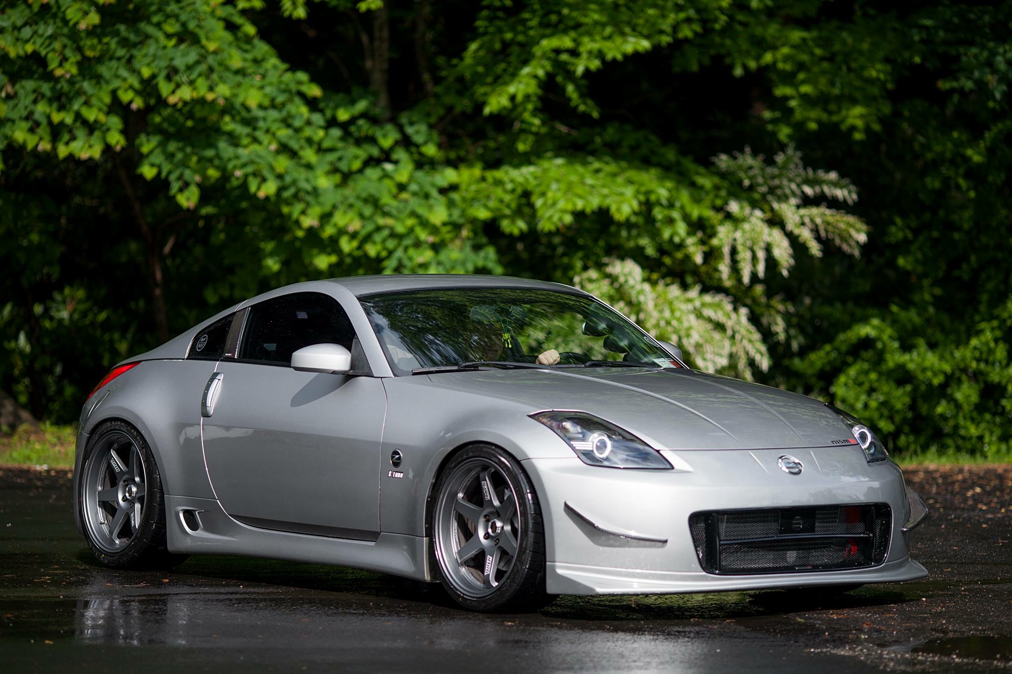

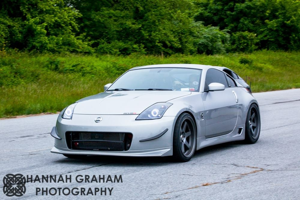

I'm using ZLEDS LED halo's/side panels. They're way brighter than the older CCFL mods and visible during the day so I'd definitely like them to turn on with the car rather than only with the parking lights.
Here they are on Staisman's car:
