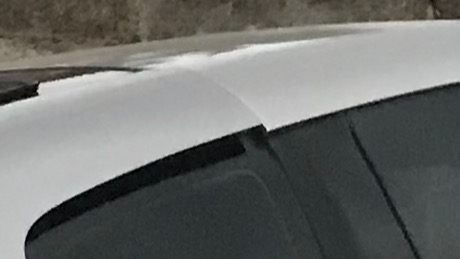

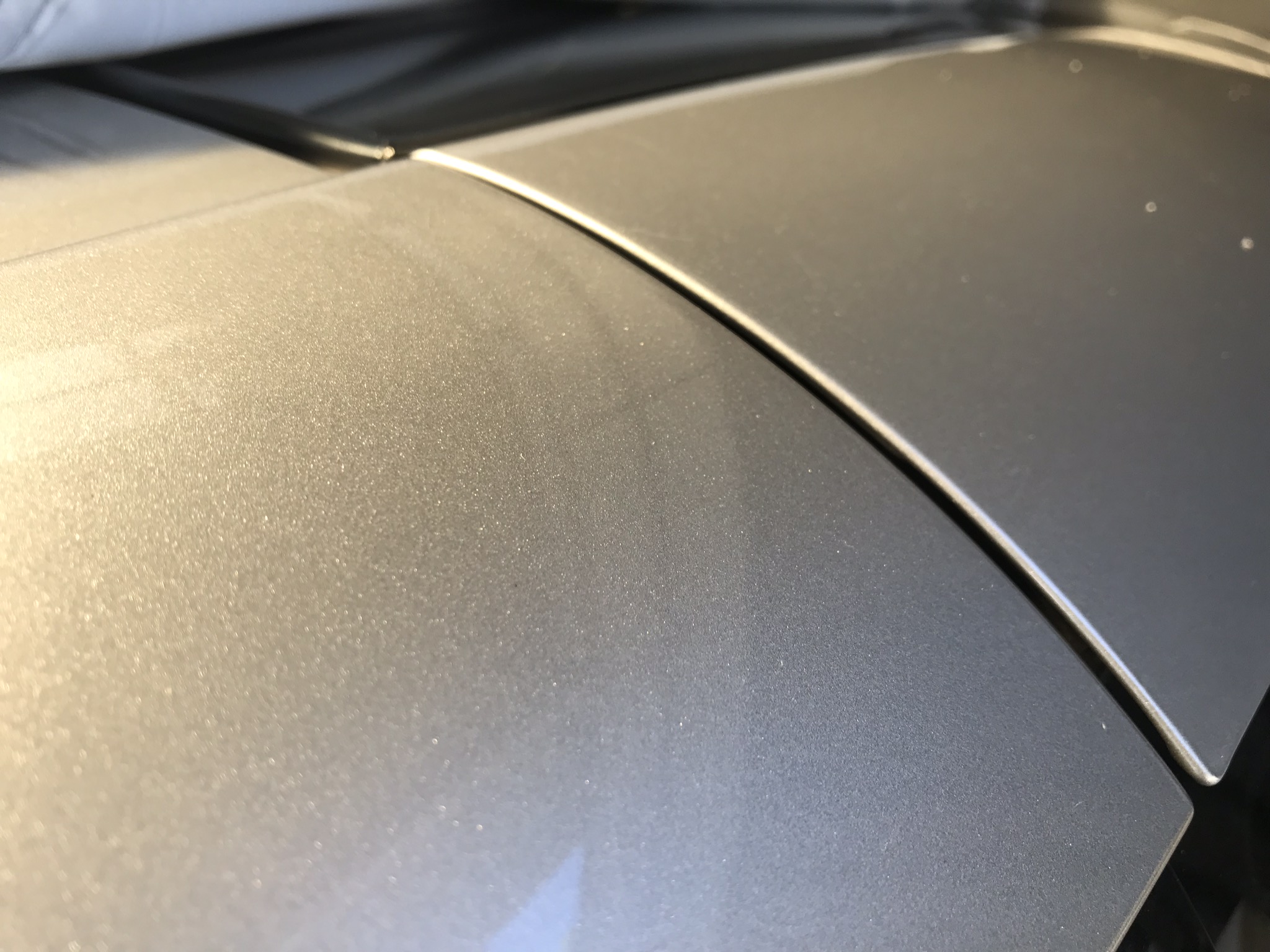

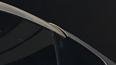

Hi guys, I know there’s been threads on this before which I actually used to try to investigate my huge hatch gap problem. It’s just unsightly, when I pressure wash the water gets inside and the road noise is stupid.
I took it to a body shop and they worked on it for a while, adjusted the lower latch, etc but told me they’d have to remove the hatch and modify the hinges in order for it to fit properly! I then went and ordered the Z1 struts which did nothing as I suspected. The originals are super strong anyhow.
So in the end after fiddling with it for days/hours I tried removing the struts completely and now it fits perfectly. I’m not back there very often so I might just leave it. Any other ideas or someone that has solved this problem? Yes I’ve checked the strut mounts 10x, they’re on correctly. I can install/take off blind folded now.
Or I could eat the cost and have the shop modify the hinge$.
Attached Thumbnails Hatch struts removed...permanent?-1ddacd48-302d-425a-b2d8-2d74bb827e7b.jpeg   Hatch struts removed...permanent?-932f2efd-9f96-4597-814f-eed3dd78f0c0.jpeg   Hatch struts removed...permanent?-69a61437-980c-4b74-83f0-9f77114138d5.jpeg

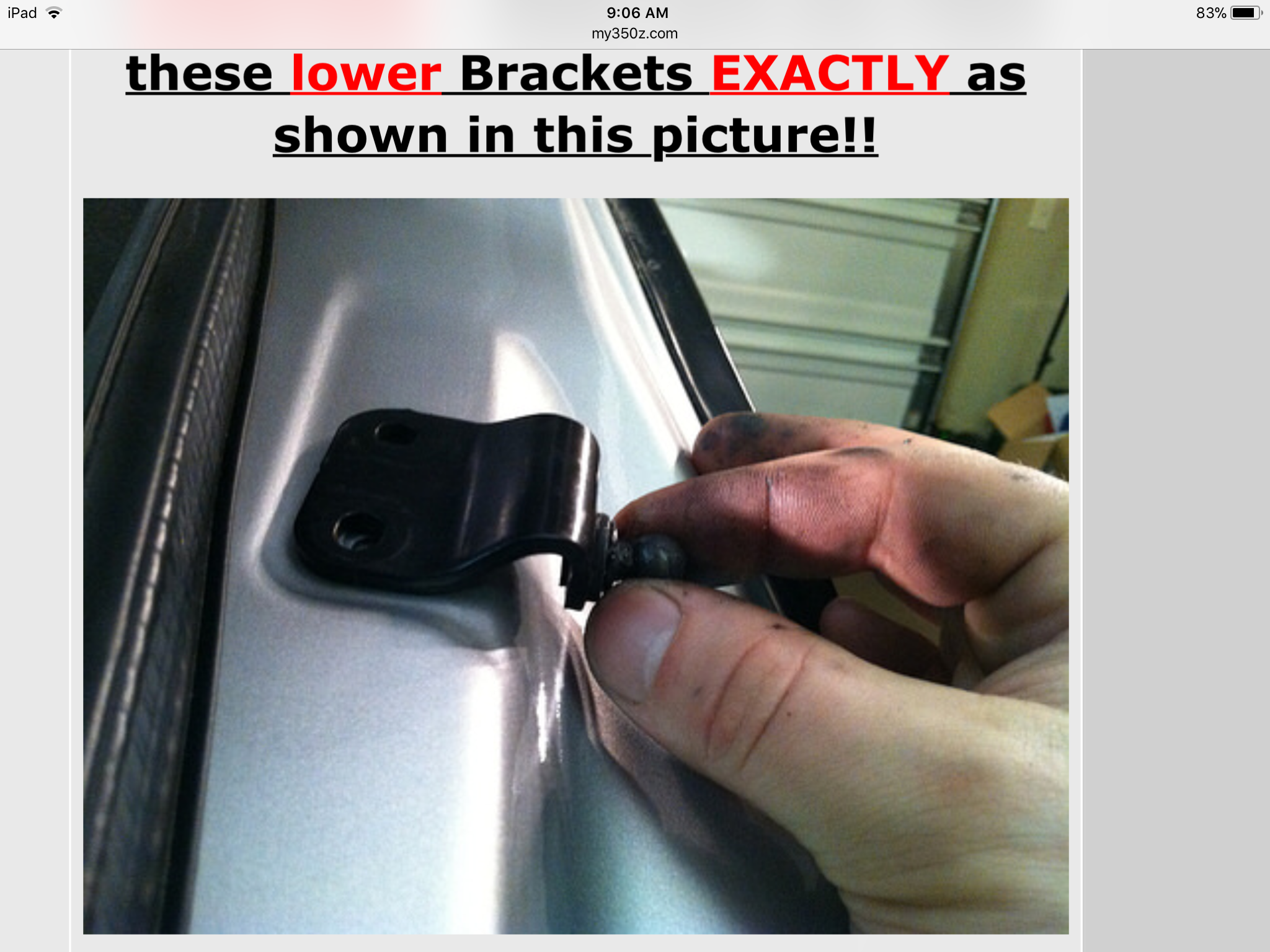

It's the mount that are attached to the car......your's are upside down. I know they look like they are mounted correctly now but trust me flip the mount over and it will close perfectly.
I’ve done it just like the tutorial/photo here, probably the first thing we looked at
