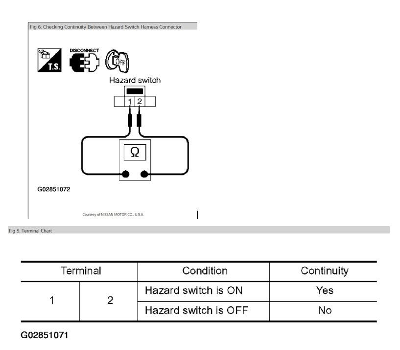

Well, if your turn signals work just fine then the problem is the switch itself, the BCM, or a short in the wiring (pinched or broken wire to ground) I would start with the easiest thing, checking continuity in the switch itself. Hope this helps
