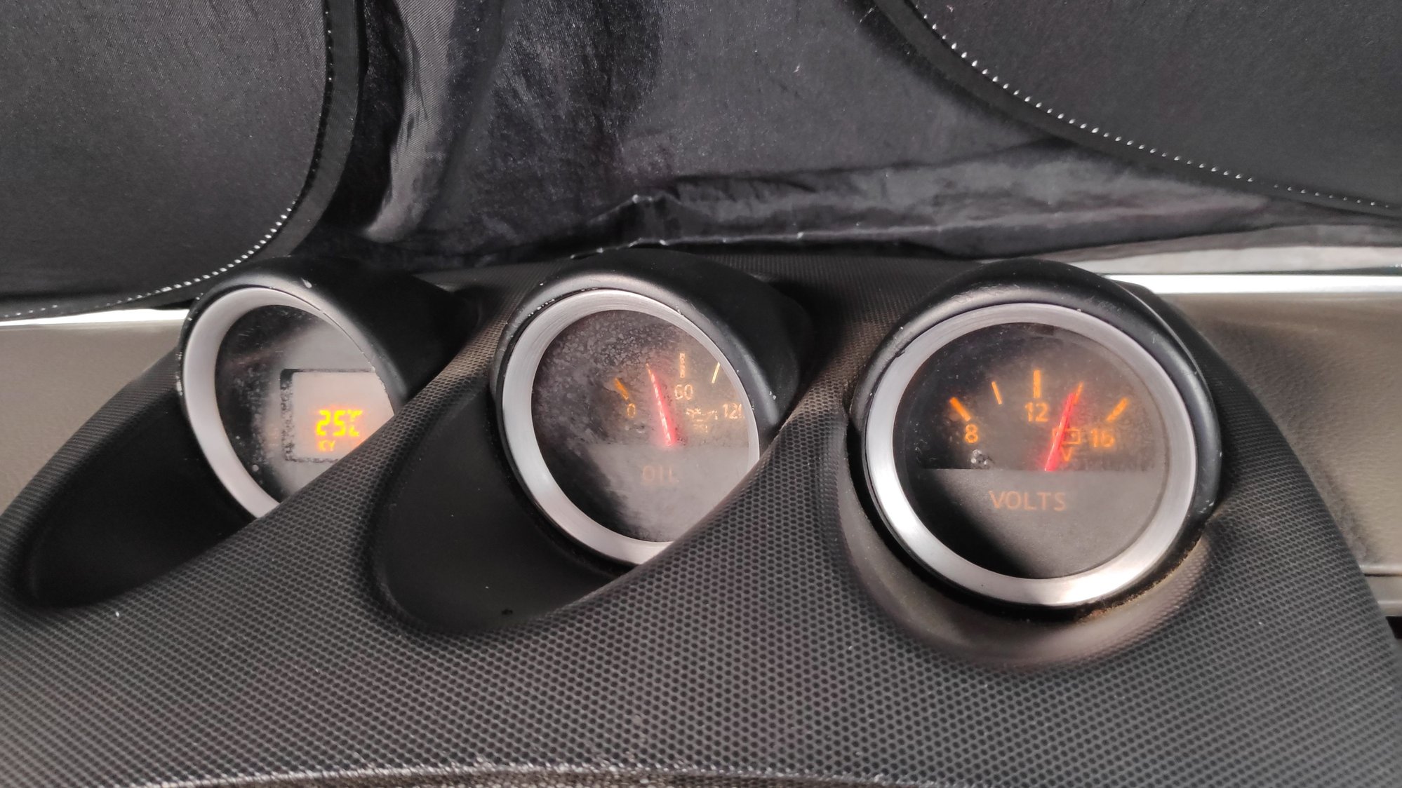

The glass for these gauges is in a scratched badly where can I find them?

The build up/scratches can be removed with toothpaste and a soft cloth. Yes, toothpaste.

I'm thinking about your gauges, that could be the easiest to find, not so easy to change. For removing the console, the forum here contains a lot of inputs, you can also find youtube videos on it.
