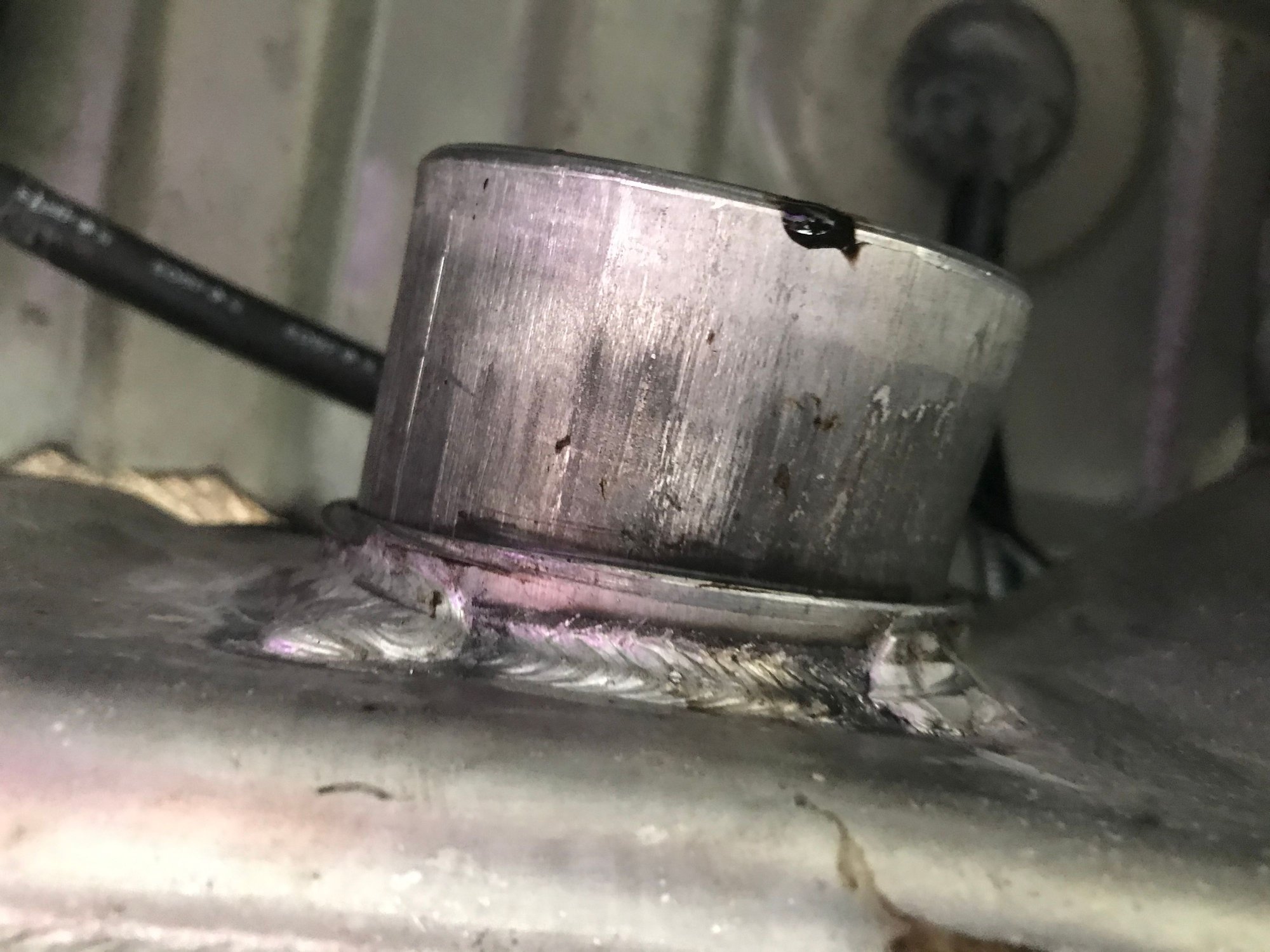

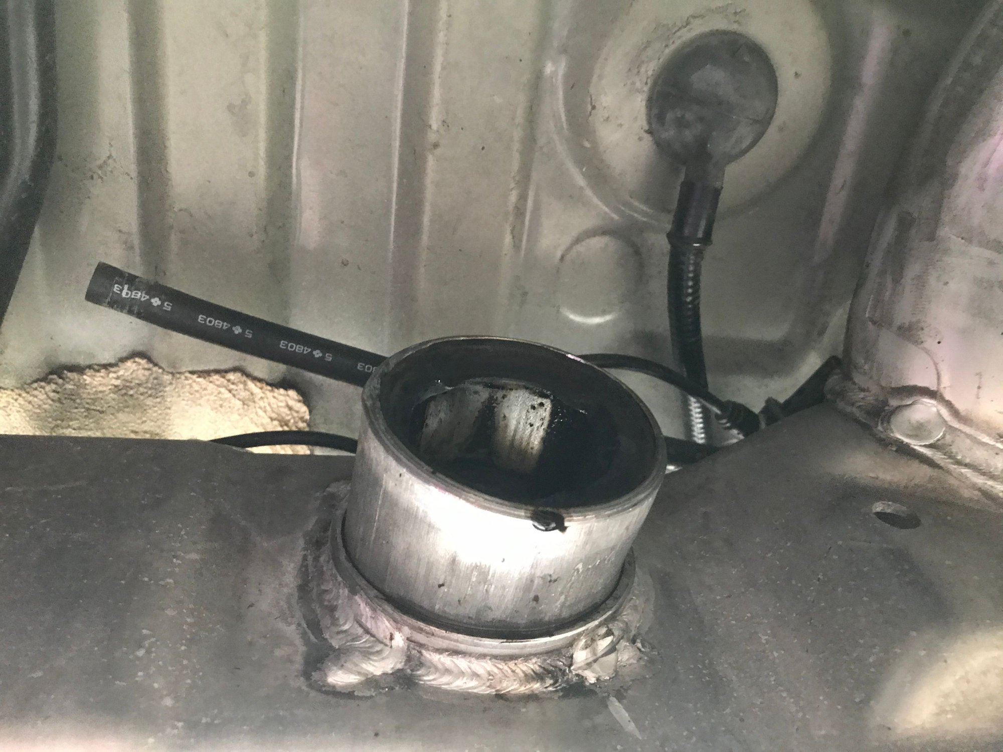

Well, this did not go as planned. So, my son did a great job supplying the muscle and it was all going well until I needed to loosen the bolt to thread it out a bit so the socket could reach the nut on the inside part. That's when I had to take off the "can" portion of the device and realize how off it is!! Now the tool part is stuck in there as well as a "little" bit more of the sleeve. The bolt is bent to hell. Apparently my son was torquing the heck out of it as you have to do. Should have paid closer attention to it as he was cranking along on it. Now what. hmmm. That thing is stuck in there solid. Thinking maybe I get a fresh bolt and try cranking down on it pull the metal tool piece back out the way it came in? IT is so close to coming through dang it. Not sure what the best approach is so thought I would stop and see what other think and also ponder it myself a bit. I have already ordered a new bolt that should be her in a couple of days.
This is the tool I was using:
https://www.z1motorsports.com/transm...l-p-11086.html

Looks a little skewed in there too....if you cant replace the bolt, you might have to drop subframe and pound it out....

I think I have two options:
1. Get a bigger hammer and pound the crap out of it to see if I cant get the tool leveled back out in the hole
2. (I like this one) Get another copy of the tool. Slide another metal puck in the hole, that way I can get the nut into the slot of that is square to the hole and then pull the entire mess out using a fresh bolt and wrenches. It's so close to coming out I think I can place the second "puck" piece on top of the crooked piece and it may level it out and push it our that final step. OR, I could put the bolt in the opposite way and try and back out the tool. I like the idea if of just seeing if I can put that sleeve the rest of the way out. sooo close. Vegas style, doubling down on it.
The issue is with the can around as you are torquing the sleeve out you really cannot see it is crooked to easily and I should have kept a closer eye on it while we were torquing it out.

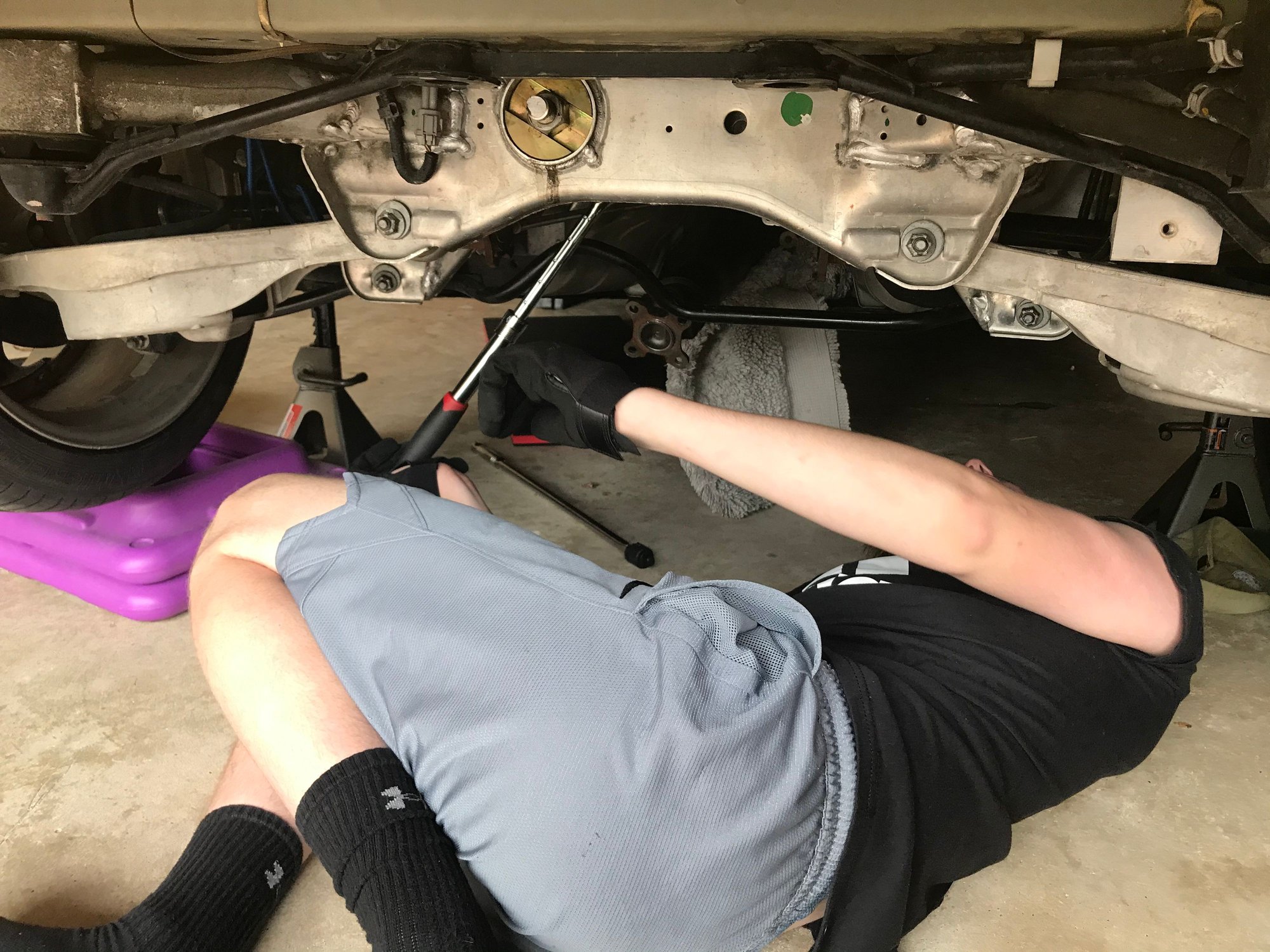

This is where we thought we had it and it was all going well. LOL I went for awhile on it and then handed over to him. Gives you a sense of the torquing down on the bolts. I told my son this thing will ultimately yield to us, were Stephens. Lessons on not quitting. My plan B and C are much more extreme if it does not yield, but it will! LOL.

May consider trying to use a long big socket and a dead blow hammer from the back side to finish it off. Looks like you are really close.
Yes, I may try a few things on it while I wait for the part. I hit it pretty good several times with shorty iron hammer with no movement at all. It does look close and I like the idea of getting a socket in there to do it. Will give a try tomorrow. One way or another we will get it out. The good news is my son and I went and saw Ford vs. Ferrari tonight and we are inspired to work on the car again! Great movie!

Just be extra careful when using iron hammers on metal. It can splinter and have a nasty medical emergency due to it. Dead blow hammers are more ideal and don't cost much at harbor freight. Dead blow is less apt to bounce as well.

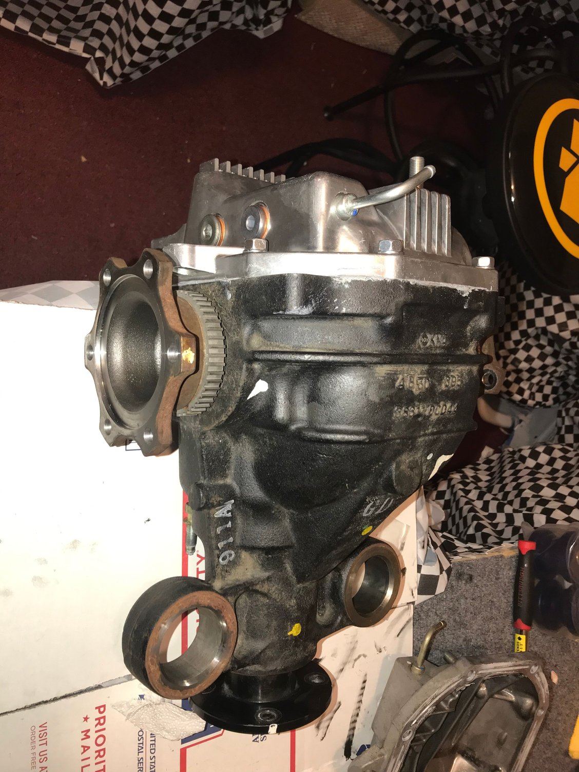

While we wait for the tools we went ahead and installed the new Diff cover. The inside was clean with no metal fragments. Looked pretty much perfect. A fun short project.

Victory! Many tools and different approaches were tried. In the end, a reciprocal saw, Diablo Metal blades(bent quite a few, and dulled them), lots of cutting oil, and my best idea, a hand held pneumatic chisel. Used a dremal tool to smooth it all out and ready to move forward.
