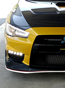

I have made custom fogs for my SC300 way back in the days. If your bumper is made of fiberglass frp you can use epoxy or JBweld. I would check with the retrofit crowd (hidplanet etc) to see what they use to glue and mount custom lights. Tons of info on how to and exactly what to do. You'll have to do some research. There were a few custom fogs from a few members who bought custom jdm aftermarket bumpers and filled in holes with fogs. Those will probably take a bit of effort to find.

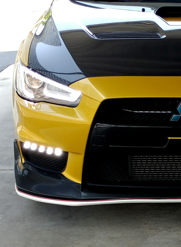

If its ABS, polyurethane then - I had to make custom mounts to fit LED DRLs on my oem front bumper, takes a bit of thinking and creativity to mount and make them adjustable. I used: aluminum stock, 3m double tape, nuts, bolts.
These are Philips DayLight 4 Gen2.
Not sure if they will fit into the holes on your bumper but I am running Piaa DR305 on my Evo X.
