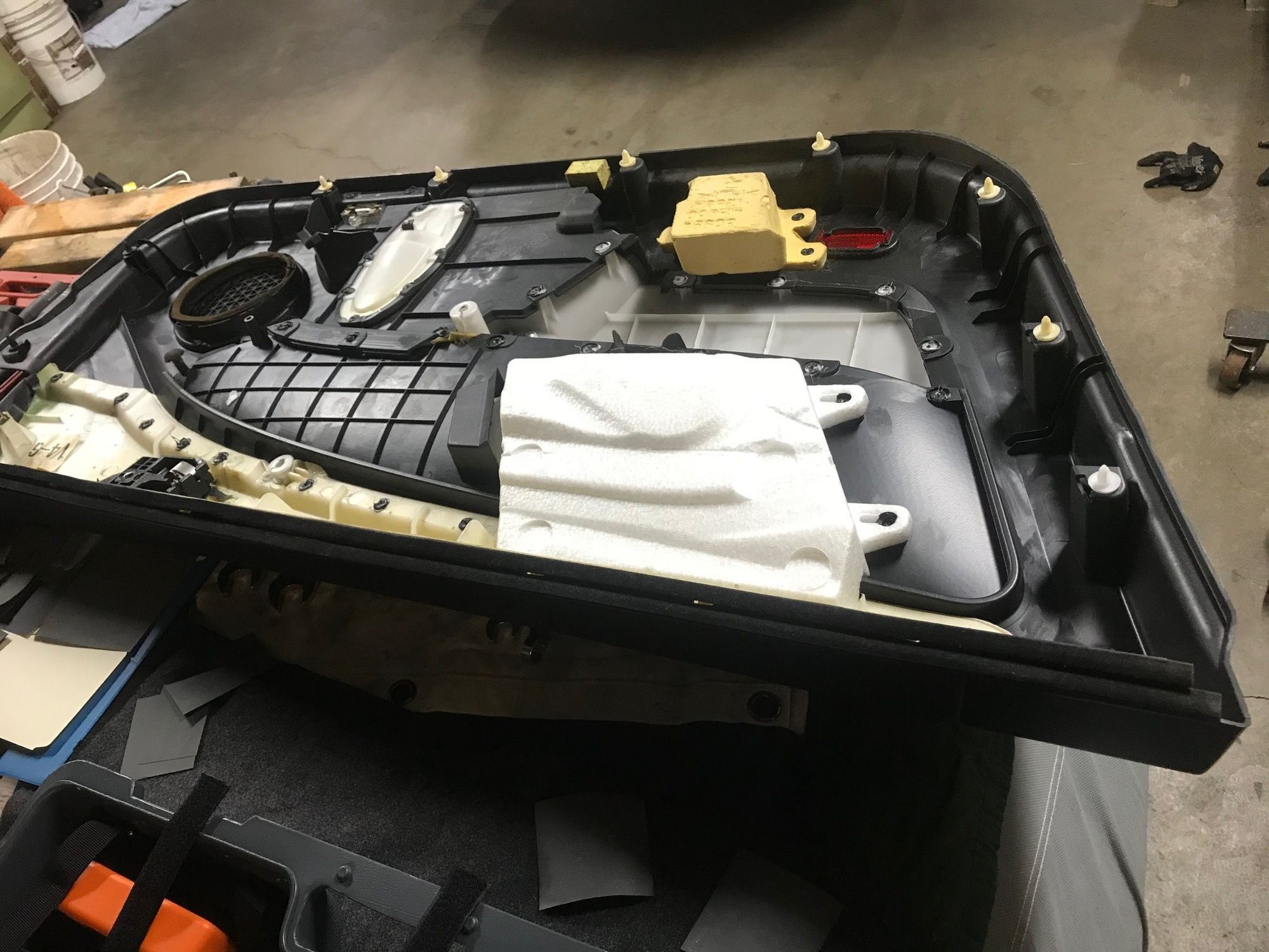

At this point I went nuclear. I was about 3 hours into this fiasco and decided to go ahead and pop the top of the panel wider even if it breaks. I took a Pry Bar, carpenters steel pry bar about 15" long, 1.5" wide and had a curve on one end and a nail puller 90* on the other end. With this for more leverage and the existing gap with my wedges I was able to slip the pry bar into the gap and slowly, very slowly open the gap up to about 1.5" wide at the top between my door panel and the door metal frame. Very scary, again I thought it would break but it did not. I inserted a couple wood blocks that were small enough to slip into the 1.5" gap and hold the panel open so I could go after the wires again. This time it was very easy, I could see down into the door panel clearly, spot the wires and pulled them up with my coat hanger wire with a hook on the end. Now one pull on the door lock cable and the door unlocked instantly. I opened the door slowly since the door panel is now half off. Once the door was open I removed the door panel normally starting at the bottom and working my way up.
No money involved, no locksmith charges, no parts ruined, my door panel is still perfect although I am really surprised because I bent it out away from the door to get in. I think with this knowledge I could open the door in about 20 minutes with a do over.
Since I took the door panel and spread the gap so slowly using the wood shims and then finally the pry bar I think that helped me not break the panel. I think if I started with the pry bar I might have damaged the outside trim and the door panel but that is just my opinion.
I took some pictures and will try to post them. Again I did this last night and the post evaporated so I hope it works this time. Maybe this will help some other locked out poor soul!

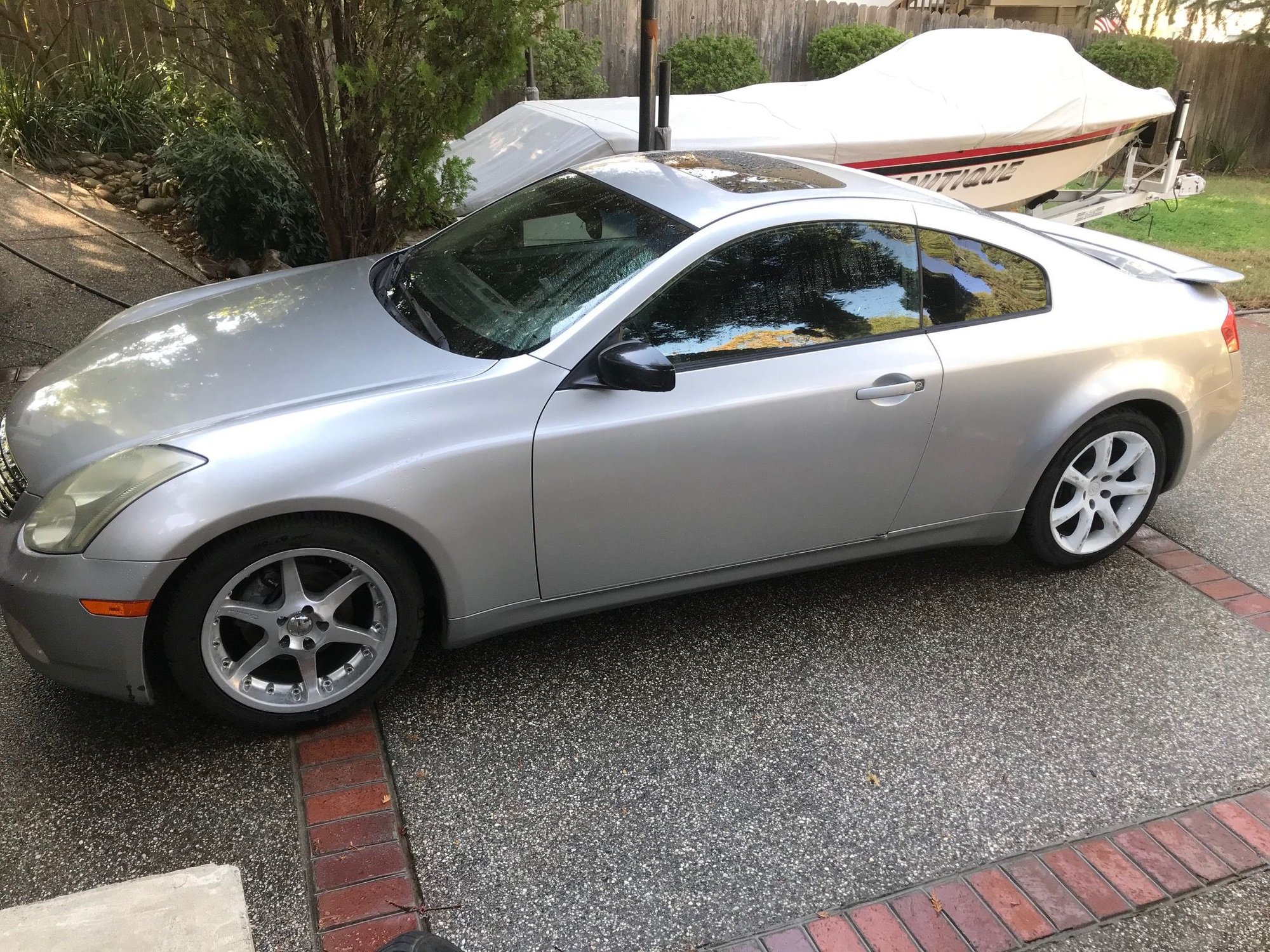

OK, tonight it posted so I will try to add the photos. (The car does have matching rims on it now, one of my first fixes) I just realized there are no pictures of the door shims/wedges I used. I had about 9 of them in use to spread the door initially before I went to the pry bar and larger wood pieces to hold the door gap open. PS: I know this is a G35 and not a 350z but your forum helped me fix other issues so I thought your forum should get the help. And they are the same car from what I can tell.
