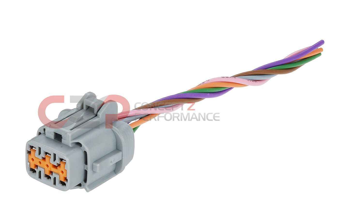

To answer your question, yes - you can make an adapter that will convert the 8-pin on your '08 to the '03-'05 6-pin connector on the headlight. Assuming that the 8-pin female connector on your Z is still intact, you will need to make an adapter that has an 8-pin male connector on one side and a 6-pin female connector on the other side.
CZP sells them, but you can probably find them elsewhere. About $20 in parts if you get it through them.
8-pin male:
6-pin female:
The two extra pins on the 8-pin connector are for the side marker and corresponding ground. You would just need to tie those two wires into the respective positive and negative parking light wires for everything to be functional.

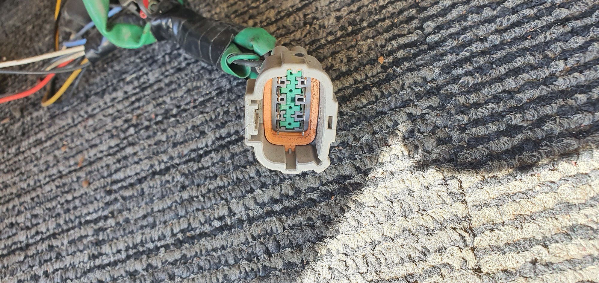

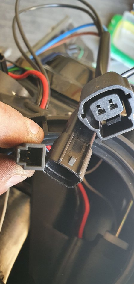

Its the secured wiring harness from the back of the Headlights.
Sorry about the delay, couldn't get to anything till the Weekend. I have attached a couple of photos, the first 3 are the wiring harness from the lights and the other 2 are from the new set of lights. As you can see most of the factory connections have been cut and replaced.
I'm in Australia and I have been through majority of our parts stores and can't find the exact plugs. Its a little tougher as I don't have the factory part numbers for the plugs either or physical reference.

Ewww, yeah, so if you're staying with the aftermarket lights, you're going to need to figure out the corresponding input wires that control the different functions and then hardwire them to that hacked up harness that came with the other lights. At least you'll know the outputs.
