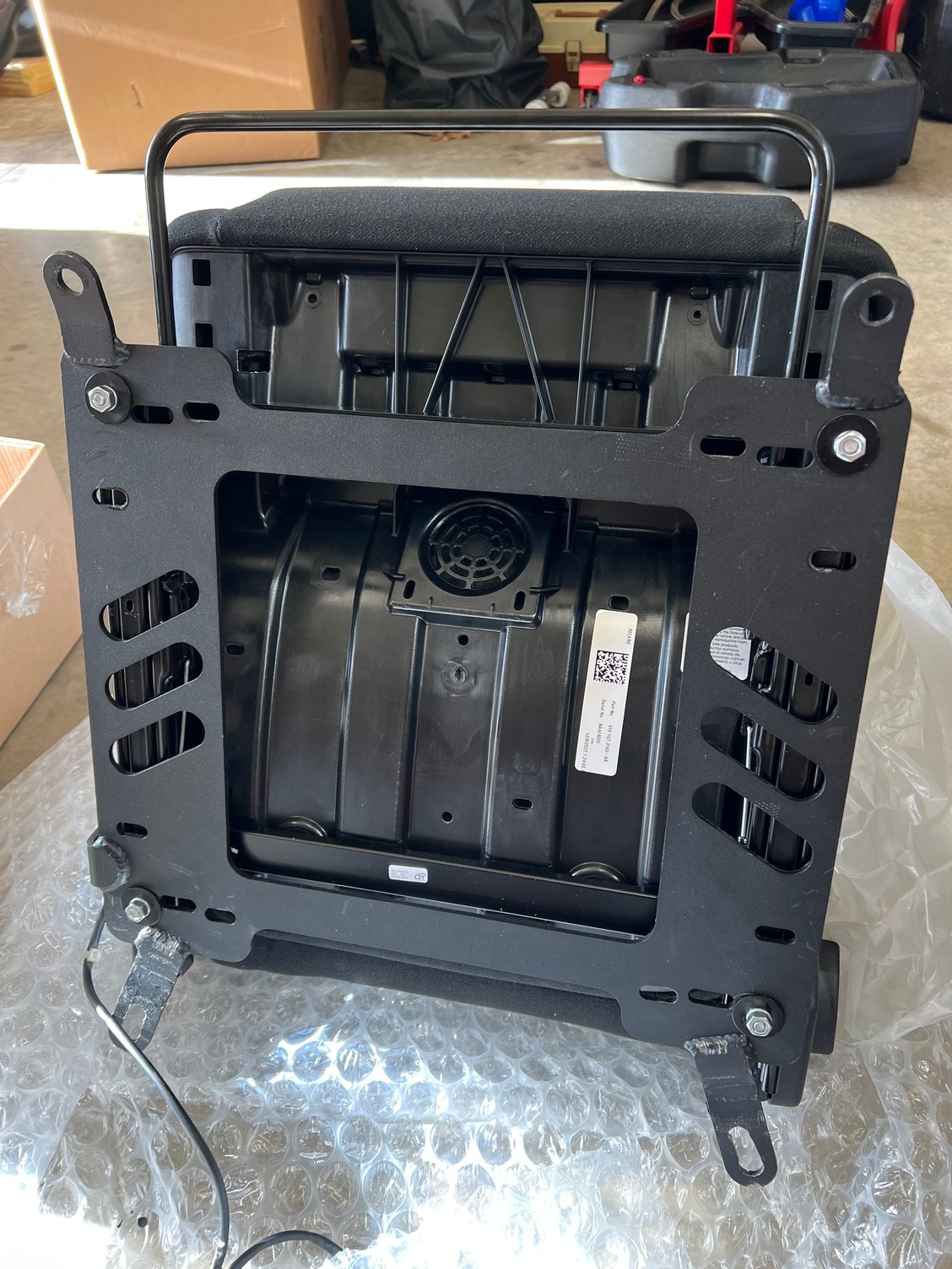

Finally got the Recaro Sportster GT seat installed (driver). I'm waiting on the planted bracket for the passenger side to come in to get that one mounted.
You can see where I modified the two tabs of the rear of the driver planted bracket to sit as flat as possible. I'm a taller driver, so wanted all the space I could get.
You will have to run a set of the Recaro sliders for these seats for mounting. I added about 2-3mm worth of washers pictured here to provide enough clearance for the tab on the bottom of the seat and the planted bracket.
