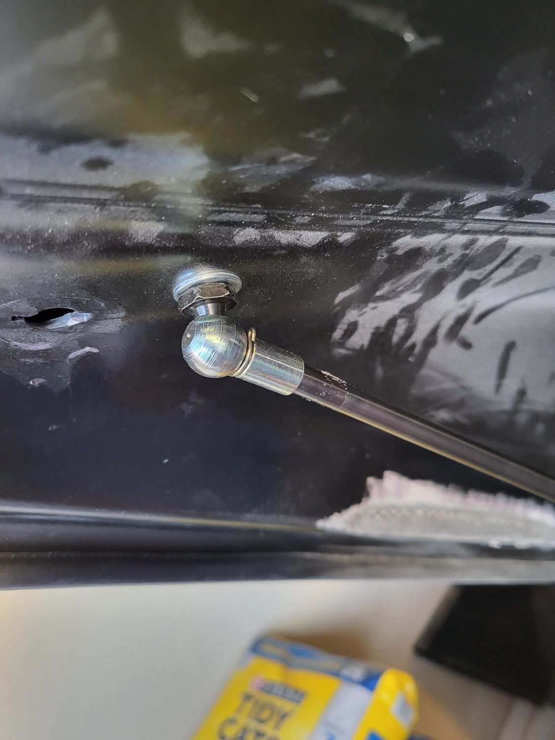

I have needed struts for the carbon hatch (VIS Tunnel Hatch w/ spoiler) for a while, but I could not find any and anyone that was selling struts for carbon hatches, no longer does. Soooooo...
I got the specs of the average struts. For the force, it seems the OEM strength is about 80lb and high pressure is about 120lb; leading me to go with 45lb struts.
The struts I used are HERE. Specs are ~ Extended Length: 20 inches. Compressed Length: 12.15 inches. Stroke C: 7.75 inches. Force: 45 pounds. $20 each.
I then bought a $20 Ebay strut kit just for the mounting hardware, since I could not find it separately ANYWHERE. So for $60, I got working hatch struts for my carbon hatch finally.
Hopefully, this helps someone.

so these struts work with the factory mounting points and tabs?

If ya still need me to DM ya after Trav's below post, I can. They mount just like OEM struts. Just have to make sure the ball studs on the hatch are correct. There are different lengths/widths that will change how much movement the struts have.

Edit. More pics + original part #. I gotta switch over to stainless ball studs/sockets too now that this actually works lol. You can see how high the hatch is raised, so adjust the strut size to match your needs.

Matthew.... your body side strut tabs are upside down tho my dude.. flip them around and the hatch will sit flush again.. very common
Thanks lol. I did not even notice. I just made sure it latched a few times and have not shut it since. Dejavu from 9 years ago.
