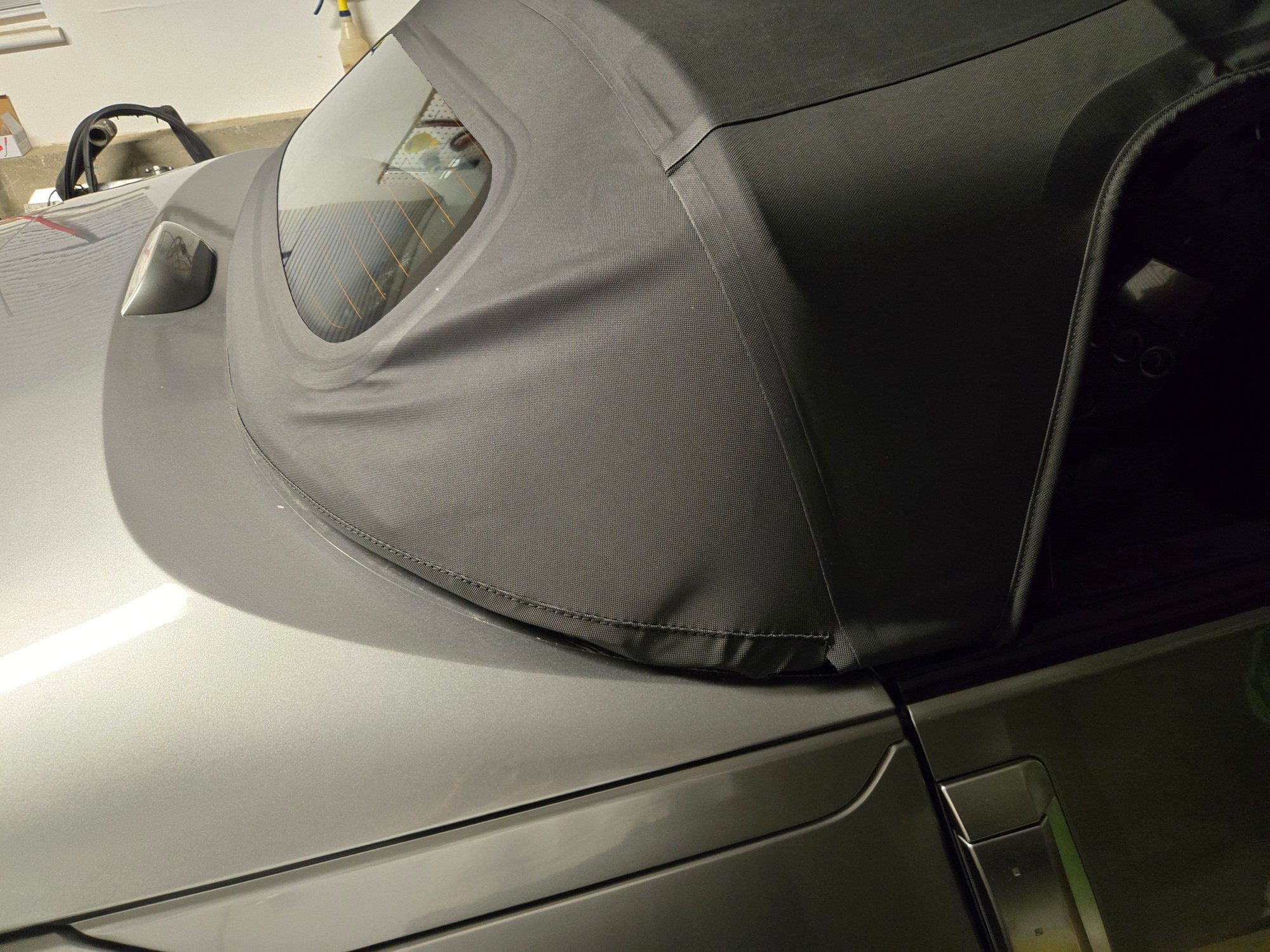

The first one had a piece of fabric that was 3ish inches too short and would not wrap over the bar at the back. I got to the end of install and couldn't finish it. Pics included.
I got the second one and measured it before install and the issue the first one had was resolved. However I attempted to put on the 2nd one and it doesn't quite fit... It is kinda short at the bottom as the pictures show. While it fits okay through most of it, it dosnt do it properly at the back corners...
I'm really tired of putting them on and getting to the end to figure out they wont work properly. There certainly seems to be many different fitments for these soft tops which the manufactures dont seem to be aware of. It is a lengthy job to install them. Can anyone point me in the right direction with this? Thanks 🙁
The first one i bought had this piece of fabric that was too short to reach the Velcro and cover the bar at the back
The one that came off my car was able to wrap back around to the bar at the back.
The second one i got seemed to work good until i got to the last step of screwing the back together. It mostly fits but as can be seen it seems to be too short in the back corners. Pulling it tight and drilling some holes helps but it also makes it very tight for the motor to close.
