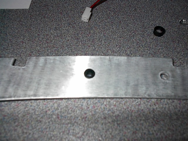

after a few threads with different LED ideas, I decided I should find a simple way to let people flushmount LEDs wherever they choose.
and Ive succeeded.
I do not know where the good camera is, so these crappy 2mp photos will have to do for now to show how the system works.

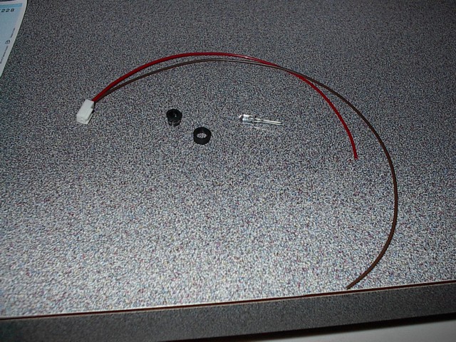

Heres the parts that it has

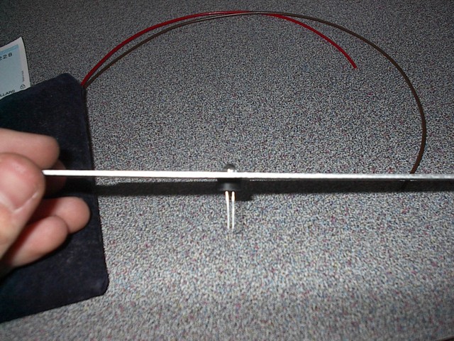

next you add the LED in from behind. then slide the holder ring in over it. for best results a drop of superglue will hold it together, but its pretty firm without it.

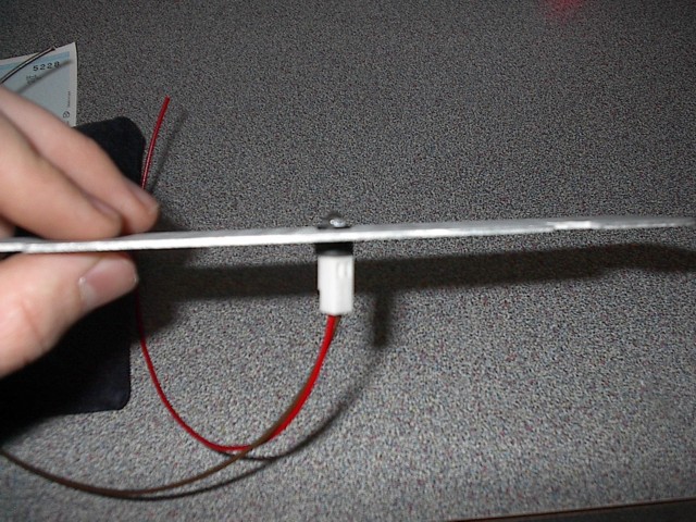

and the final step, you simple slide the connector onto the LED leads.
