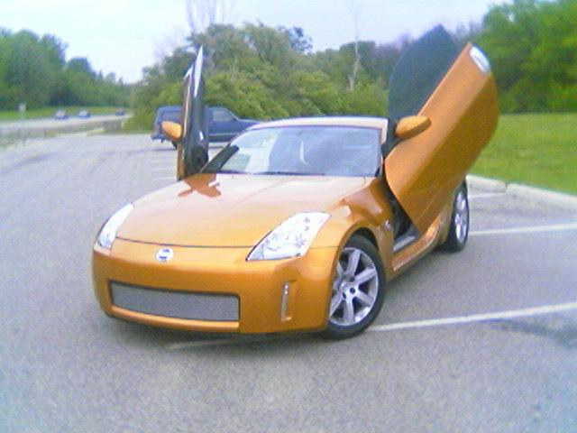

i got my decah kit from aspecmotorsports for 1300, BUT paid another 1400 in labor to install the damn thing. i still saved a ton over what carexcess was charging with labor.
HOWEVER, i dont reccomend aspecmotorsports. the decah kit they're selling is not modified to specifically fit the 350z. your installer will have to do some major modifications and most likely some welding to keep labor costs down.
i dont know if anyone else is having this problem, but the inside of the door panels will get worn out over time from all the rubbing, so the door panels will have to also be modified. im waiting on my 2 new door panels to come in.
make sure your installer knows what he's doing. i had idiots working on mine and it took them 15 days from start to finish. i just picked her up yesterday.

Damn sorry to hear that but yes I do also have issues with the inside of the door panel rubbing on the upright supports. Simple solution is getting a nice cushiony tape that you cant see while the door is closed and barely noticeable when open to pad the area. The upright enforcement is only fiberglass ( or something else not super sturdy I'm not 100% sure ) over metal so it will crack with the pressure from the weight of the door i've seen it on a few lamboed cars. Don't keep them up in high winds
