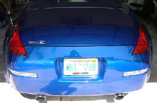

Old May 27, 2004 | 12:26 AM
FLZ's Avatar
FLZ
Posts: 1,055
From: Boca Raton, Florida
Default Follow JokerDev's instructions
Real easy to remove. No agents at all.

Old May 27, 2004 | 08:00 AM
orhanz33's Avatar
orhanz33
Posts: 1,559
From: North Jersey
aren't there any holes left behind when you remove the nissan emblem?
Old May 27, 2004 | 11:31 AM
estes's Avatar
estes
Posts: 10
From: Louisville, Ky
They are glued on. No holes . Estes
Old May 27, 2004 | 12:08 PM
KrazY-2K's Avatar
KrazY-2K
Posts: 1,056
From: ... aren't you?
I thought the Coupe had holes on the rear hamburger emblem? I remember a thread where someone stated that only the roadster doesn't have the holes.
Old May 27, 2004 | 01:07 PM
estes's Avatar
estes
Posts: 10
I'll let you know when I get it off.
Old May 27, 2004 | 05:07 PM
orhanz33's Avatar
orhanz33
Posts: 1,559
From: North Jersey
there must be holes... if there wasn't i know i'd see a lot more pics of Z's w/ no nissan emblem on the hatch
