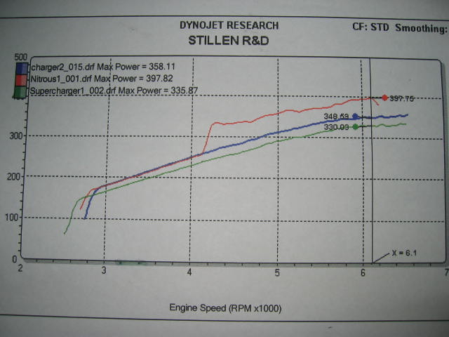

I just thougth I would share with you the potential of the Stillen supercharging system at it's maximum reliable boost pressures.
The 397RWHP is achieved through the addition of a 35 shot nitrous system.
The 360RWHP is 8psi boost only. The 335 was at 7psi
All three dyno runs had excellent AFR's in the mid 12's post cat.
This set up is not entirely stock, there are other aftermarket bolt on's and a Wed car on good gasoline helps.
I am including the Torque sheet in the next thread.
A FULL motor rebuild is in the works with all new forged internals,cams,port work,ETC. This should be completed by the end of Jan.
I will keep you posted!
