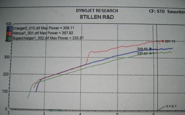

I just thougth I would share with you the potential of the Stillen supercharging system at it's maximum reliable boost pressures.
The 397RWHP is achieved through the addition of a 35 shot nitrous system.
The 360RWHP is 8psi boost only. The 335 was at 7psi
All three dyno runs had excellent AFR's in the mid 12's post cat.
This set up is not entirely stock, there are other aftermarket bolt on's and a Wed car on good gasoline helps.
I am including the Torque sheet in the next thread.
A FULL motor rebuild is in the works with all new forged internals,cams,port work,ETC. This should be completed by the end of Jan.
I will keep you posted!

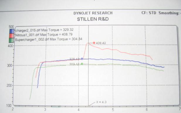

The 408RWTQ is achieved through the addition of a 35 shot nitrous system.
The 330RWTQ is 8psi boost only. The 305 was at 7psi

Since when is mid 12's a excellent A/F? Mid 11's would be a lot safer.
-Mark

Post cat.... Please read my post
That means you add .5-.8 to the reading which = 11.8-11.5

So, making about 300whp at 6.3psi, I can expect about 320-325 at 7psi, and about 340-345 at 8psi, I guess. I wonder what/when will this be released. I was gonna bug the service at Stillen to sell me the race pulley only... I sincerely think no changes are needed in fuel delivery. However, belts and heak soak... ahh... I'd like to see you combat 100F heat here in Houston . Read: need bigger intercooler and water spray chiller. Sell me that as Stage IV upgrade and I'll bite.

WOW! I've never seen a dyno like that before.j/k Looks like a set of stairs.This wed.we'll see how mine looks

Good numbers, Znitro! Definitely should be fun to drive, but I wouldn't want to deal with that power spike (from the N2O) on a track run.

I was actually thinking about drifting through a corner getting on the gas and suddenly having a jump of 50hp from what I was feeling only a fraction of second before!
Seems like a good way to wind up with your car pointing the wrong way. Wonder if the N2O could be bled in slower so the jump is as on/off in nature...

I read your post very carefully. I have never seen that much variance going with a tailpipe sniffer.
-Mark

Smart Azz, You know what it feels like!
Ni is not for tracking / Drag racing yes

What nitrous and dry or wet?
Nice jump....but turn it on sooner?
