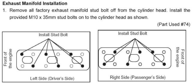

Peter,
I don’t mean to argue with you on your TT kit, you definitely know it better than anyone on the forum.
However, I would like to point one thing out in your reply, and that is the cylinder heads do have 4 studs/bolts mounts per port, you can see this in a lot of pictures posted on the internet and also can see this on the GReddy install manual and also the “APS” installation manual on page 10 point 2 under Exhaust Manifold Mounting Studs – DIAGRAM – EMA/01 and I quote
“Install the short threaded end of the stud (Item 74) in the indicated (diagram EMA/01) hole in the LHS cylinder head. Check the correct fitment location by temporarily holding the LHS exhaust manifold in position. The stud (Item 74) should protrude through the extended mounting boss on the exhaust manifold, immediately ahead of the turbocharger mounting flange”
If the cylinder heads only have 6 mounting studs location on each cylinder head, why did APS installation manual mention that the installer should pay attention to the location of the mounting studs?!! Furthermore, please refer to the attached picture from the GReddy manual.
On the Ultimate Racing kit using a Garrett Ball Bearing turbo, I don’t think its necessary to question their integrity. We are all here to understand the 350z better and the products that are available in the market for the car.

I understand you're not intending to argue the point and neither am I, just wating to make sure that the facts are correct, that's all.
I believe that the exhaust manifold gaskets are made to suit both the left and right hand side cylinder heads, in other words Nissan produced one exhaust manifold gasket to suit both cyl heads, this is why the diagram shows 4 bolts per port when in actual fact only 2 studs/bolts are utilised pe port (6 bolts per exhaust manifold, does this make sense to you know? Seems to me that the greddy pictures/info is incorrect as you can't fasten the exhust manifold to the cyl head with 12 bolts.
The APS manual states to pay attention as there are 6 studs to tighten, a normal instruction to provide no matter how many studs there are to fasten. I can assure you that there are only 2 bolts per exhaust port (if you get a chance have a look at a cyl head for confirmation) and you're confused as you're looking at the exhaust manifold gasket which had been made to suit both cyl heads, hence the 4 bolt pattern

for crying out loud.
you can use 4 exhaust manifold studs per cylinder if you wish. From the factory only 2 per cylinder used, but there are in fact 4.
aalzuhair knows because he installed his turbo kit, Peter.

I stand Corrected though only 2 studs per exhaust port are utilised on the Factory manifold and what's with the aggro attitude?
