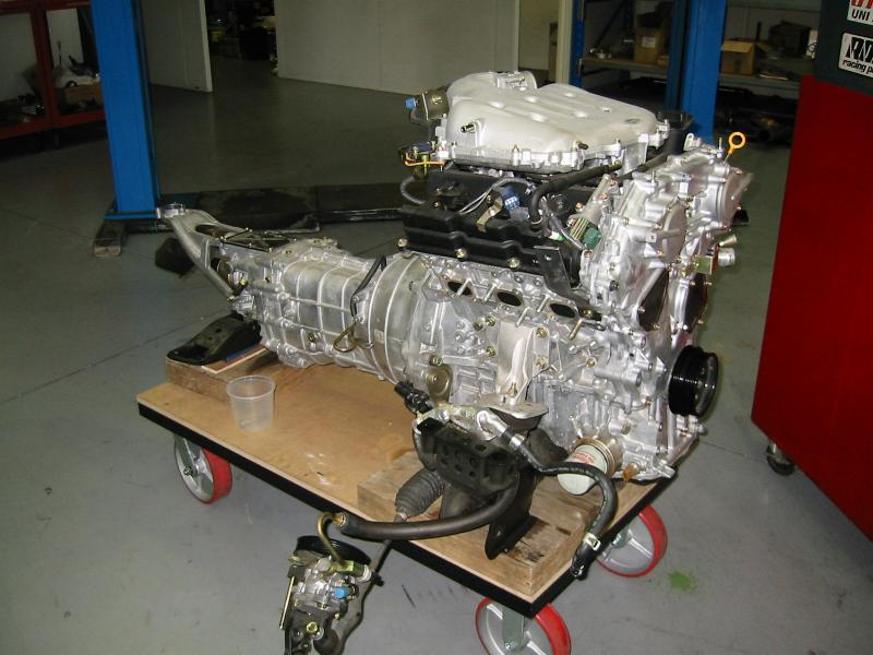

The Nissan cylinder heads have 4 studs locations for every port!! Thus 3x4=12 for each side. And of course the kit comes with new studs
Check and see:
https://my350z.com/forum/attachment....postid=1218966
