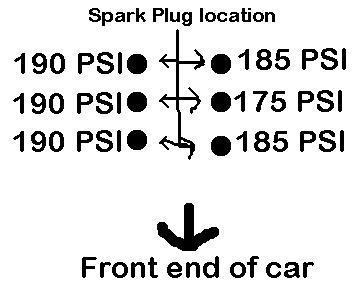

i was having problems with my engine making a clunking noise on warm starts. somone brought up that i should do a compression test.
i just finished getting all the readings and i noticed that i have a 15psi difference in one of the cylinders. i retested 2 times with the same results.
is that normal?
im not sure what the numbering system is on the cylinders but heres what i got.

Well 185 is standard and minimum is 142 and it says that max difference between cylinders should be 14, so even though your drivers side seems low you are still OK. Did you follow the proper procedure and follow up to verify lower readings per the manual?
Not sure how a compression test would diagnose a clunk though.

I wouldnt worry with that one 15psi difference. Might just wanna recheck sometime in the future. I'd say your engine is in decent shape.

thx for the info westpak, i did follow those exact procedures. except for disconnecting the fuel pump fuse. forgot about that.
last time i ran nitrous was 7/28/04 and this problem just came up about a month ago. i was running a 125 shot dynoed slightly rich.
a little more backround info. this problem of clunking started happening about a month ago. when the engine does make that sound, the whole car shakes slightly as if something got wedged in the engine. it only happenes when the car is in park and on a warm start. never on a cold start.
as for metal chips. there was some metal on the spark plugs. very very tiny pieces but they were there and you can easily see them.
would i damage the engine if i disconnect the coil pack while the engine is running? can i just disconnect the power clip that connects to the coil pack instead?
thanks for all the help. its very appreciated.

If you disconnect the clip from the wiring harness to the coil pack when the engine is running then that will stop the ignition spark from going to that cylinder. That piston/rod will just be along for a free ride....no damage done. If there is a bearing problem then the rod will knock when the ignition fires the fuel mixture. If you disconnect the coil and remove the spark you wil get no ignition and no pressure of the piston and rod down on the crank....and no knock. You will be able to tell right away if you connect and disconnect the coil clip and the knocking comes and goes with the firing of the sparkplug. You may get a check engine code but just reset the ecu after the testing.
If you had metal on you sparkplug and it was noticeable to the naked eye then you had a detonation event. That aluminum is from the top of the piston. You may have damaged a ringland or burned a valveseat in that cylinder with the lower compression. That would explain things.
