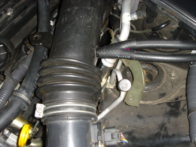

here. Sorry, I hid evrything but you can see a little.

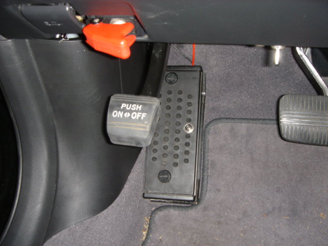

here's another

cool, how about solenoid mounting locations as well

I wedged my zex box(which has both gas & n2o solenoids inside) & my widow switch under my master cylinder. they are both easily accessable. I made longer wires to the widow switch so I can rest it on my window when I'm testing.
