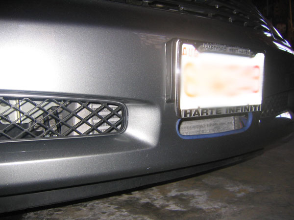

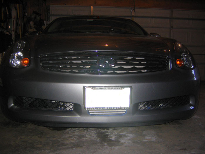

2) Had Jeff, Avalon's top level mechanic, fabricate a rectangular hole in the center of my front bumper just under the license plate and right in front of the intercooler for WAY better ventilation. It took him about 10 minutes. I'll post a picture soon.

Here goes.

Another view of the bumper slot.

first one has 2 holes and second has 1 bigger one . Must have made it bigger . Looks good

Think you're mixing me up with someone else. This is the first and only slot in my bumper.

The first shot ....LOOKS ....like there is 2 openings....but I relooked at it . Its the intercooler that makes it look that way

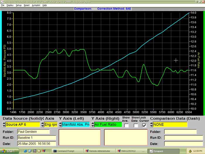

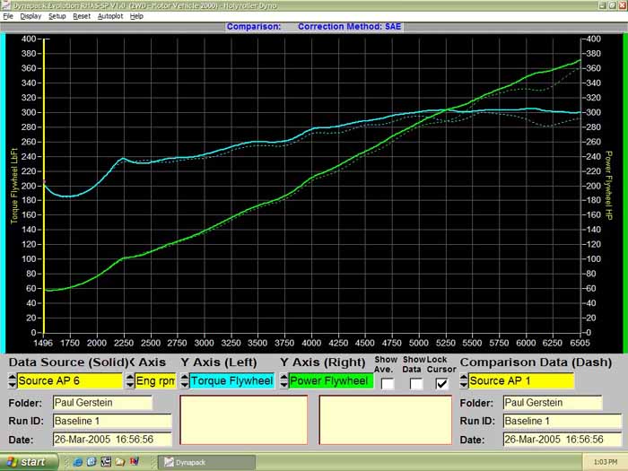

All right-- here are the dyno charts. On the standard HP and TQ chart, the dotted lines are before the tune, and the solid after. Notice how close the factory settings were to perfect.
The waviness of the AFR vs boost graph between 5-6K RPM is to some degree an artifact of the spread out y-axis.
Regarding the "flywheel" headings, these are actually rear wheel readings with total equivalency to a roller dyno except for much better repeatability. I had about 8 pulls that were just about identical in their max numbers. Here's some info just sent to me by Giles, the owner of Holyroller Dyno in New Hampshire. They have a Dynapack that, being portable, they can truck to any location:
Hi Paul,
The numbers are wheel horsepower and torque. We used a correction ration of 1:1 instead of 1.21:1 hence giving us actually numbers at the wheel hubs. There is no parasitic loss factors etc. The numbers on the plot is exactly what was delivered to the dyno hubs. This is much more accurate and repeatable a reading since tyres heat, cool, deform and slip. I would say that the folks that are making 360 rwhp have poor tuning since yours is very mildly tuned. My dynapack is one of the latest generation of dynapacks that does not read high. If you check out some of the other plots on the website you will see that they are almost exactly the same as folks have been seeing on a DynoJet under ideal conditions. This number of accurate and repeatable and SAE adjusted on the dynapack.
It was great to meet you and itÃÔ a very nice setup you have.
If you want any more combinations of graph just let me know.
Thanks again,
Giles

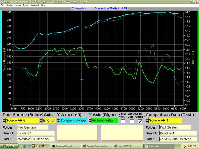

Asked Giles specifically about the irregular AFR curve between 5-6K RPM. His answer, just received and the attached chart comparing torque and AFR before and after:
Date: Mon, 28 Mar 2005 13:24:42 -0500
To: Giles Gilbert <giles@holyrollerdyno.com>
Subject: Re: Message from G35 owner
Giles-- That's fantastic. Dynapack is definitely the way to go. I'll give you guys a well-deserved plug on the forums.
I've got a question about the AFR--should it have been a bit flatter in the 5-6000 range or do you think the tune was just right?
Thanks--
We hit the same issue with AdamÃÔ 350Z. It appears totally based on the design of the engine. We ended up either really lean or a little rich. The difference between the really lean and a little rich was tiny in the amount of torque so really not worth wasting time and money over .... Attached is a plot showing exactly the difference during your dyno session.
