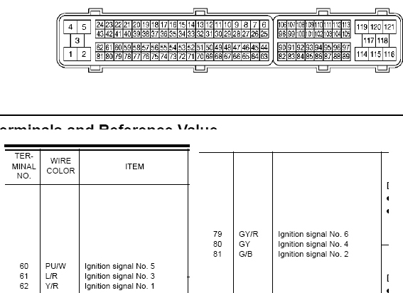

Ok The car runs with th J&S but awfully. I will have to check every wire again to make sure that I didnt pick the wrong wire for the coils. Is the second input on the box a gray wire. All the other wires for the coils are two colors not one color. Maybe this is the wrong wire. Thanks
For cylinder 4 it says the wire is green yellow. I think tahts my problem. I cant find the green/yellow wire. Its an 03 Z.

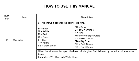

I think that is the mistake, cylinder 4 is coded GY which means grey on pin 80, green yellow would be G/Y

I did use the gray one. I think there is only one gray wire. The duplicated wire was yellow and red and there was one other I cant remmber right now.

pics
Attached Thumbnails installed J and S and car runs awful!-wirecolor.jpg   installed J and S and car runs awful!-iginition.jpg
