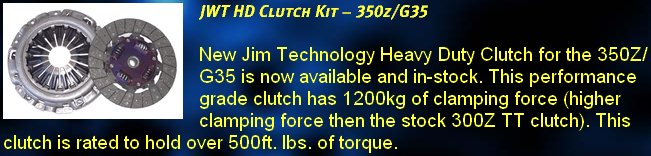

The selection of a clutch is very much dependent on the style of driving you plan on..and the power levels of the engine..It becomes a cost trade off much like 002-M-P says. Run it hard and hot and sooner rather than later it will burn out. Run it mostly moderate with occasional times hard and it will last longer. I drive the latter and find the JWT with 50% more clamping force than stock to be ideal for me..It also feels like the stock..
Old Apr 14, 2005 | 10:31 AM
Apexi350z's Avatar
Apexi350z
Charter Member #50
Posts: 3,552
From: Houston, Texas
jpc350z, is this the one you are using?

jpc350z's Avatar
jpc350z
Posts: 1,041
From: columbia md.
[QUOTE=Apexi350z]jpc350z, is this the one you are using?[/QUOTE
Yep that's the one..

No problems with the JWT clutch/flywheel. Love it.
