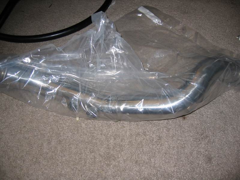

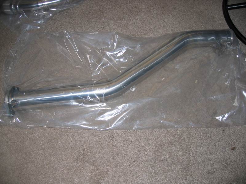

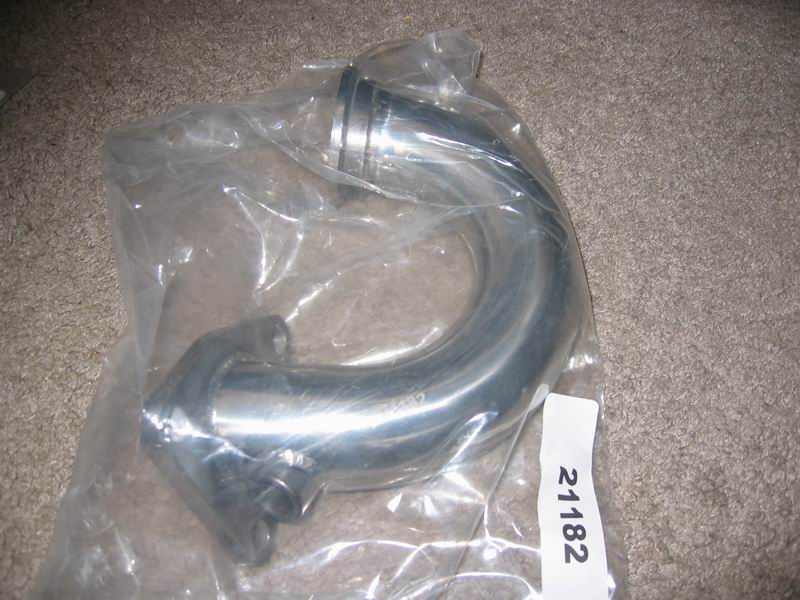

There are a total of 5 bungs welded onto various exhaust pipes in this kit. Two of them are used for the factory O2 sensors. Does anyone familiar with this kit know if the others are suitable for use with a wideband or EGT sensor?

Ok, I got the scoop from Johnny at Turbonetocs. The placement of the 4 sensors is not very clearly detailed in the current manual so hopefully they'll fix that in the final version.
The A/F sensor from the driver's side exhaust manifold goes into the u pipe (second picture). The passenger side A/F sensor stays in the manifold. The 2 heated O2 sensors in the cat pipes go into the intermediary exhaust pipe (third picture). The order that they are installed in doesn't matter. The remaining 2 bungs in the last exhaust pipe (first picture) are for optional accessories such as a wideband A/F sensor.
