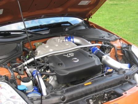

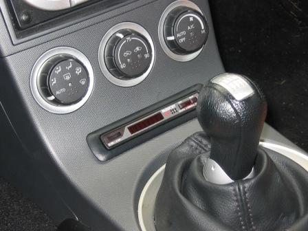

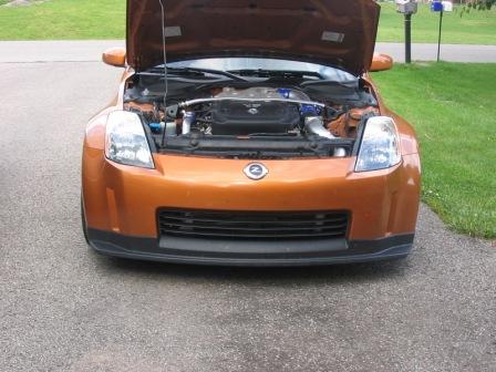

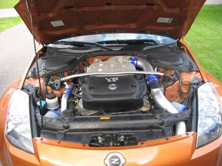

These are pictures of the overall engine compartment.
Attached Thumbnails Installed Power Enterprise TT kit-pe_tt-web.jpg   Installed Power Enterprise TT kit-pe_tt-2-web.jpg   Installed Power Enterprise TT kit-pe_tt-3-web.jpg

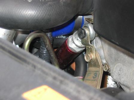

Default Stillen Damper that could!
Somehow the Stillen Engine Damper I install a week before the TT install survived! It fit, somehow.
Attached Thumbnails Installed Power Enterprise TT kit-stillen-damp-web-2.jpg
