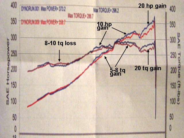

Well just got home from my dyno. Mods are 03 G35, Crawford Cats, Kinetix SSV, Alphawerks headers, Vortech with stock pulley. I made 373.2 HP 296.2 TQ. He said the norm setup on a stock car has been showing 330 at the wheels. But my cats and headers put my at 373rwhp. He said the new IM made about 5hp. YES 5HP. Keep in mind this was Rob from Z car garage. This is his second dyno with the new IM and said the other results were about the same. He did say it looks good, but thats about it My tune is very safe. I dont have a scanner but maybe Ill try and get a pick of my sheet.
lemme repost your graph with my notes....

I think this a pretty good show of hp increase. 20hp. I would say don't post results until you have them. i.e. tune your A/F. If you tune to a proper A/F your hp will go even higher. Many people have bolted on a $1k exhaust system and lost hp. This is "untuned" and way richer.

Untuned? I just had it tuned. Im not going to raise my air/fuel. Its safe now. I have the Greddy evo2 and that has a Y pipe in it. So I dout I lost HP. I also have high flow cats and the alphawerks headers. I hope I can get Rob to post on this and give his thoughts.

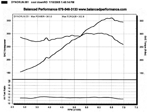

Default A/f
Hi G352NV,
You said your car had been tuned. The chart I am looking at show that it is off the page rich in two places, with a weird jump in between. I have a G35 Coupe and you could use my A/F chart as a straight edge. Mine could have been tuned to a more straight line but the person tuning it said why bother.
This chart shows 361hp and my best to date is 375hp. I have an automatic. If it were a 6 speed it would be in the low 390's.
AlanL

I have noticed a few interesting thingsregarding some of the recent dynos.
I dont think it is accurate to say that if the A/F goes richer, then it must be flowing less. What is consistent with all of the dynos (every dyno has shown increase except for Lemans350z) is that it has shown gains while the A/F has gotten richer.
I believe Lorca from Z1 showed about a 10hp increase, and that was no tuning done between runs, and the A/F was richer by about 1 point. If the manifold flowed less, than it definately wouldnt be showing 10hp gains. I would like to see the car tuned to the previous A/F ratio and then compared with the before run.
This does not however explain the other recent dyno from lemans350z which has the A/F going off the chart rich, and then even when R4 adjustments were maxed out, they couldnt get it back into the previous A/F range.
