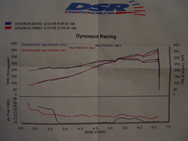

Well just got home from my dyno. Mods are 03 G35, Crawford Cats, Kinetix SSV, Alphawerks headers, Vortech with stock pulley. I made 373.2 HP 296.2 TQ. He said the norm setup on a stock car has been showing 330 at the wheels. But my cats and headers put my at 373rwhp. He said the new IM made about 5hp. YES 5HP. Keep in mind this was Rob from Z car garage. This is his second dyno with the new IM and said the other results were about the same. He did say it looks good, but thats about it My tune is very safe. I dont have a scanner but maybe Ill try and get a pick of my sheet.

Pic

Originally Posted by G352NV
Pic
My tune was questioned when I was only showing RWHP in the 330's with Vortech SC. Some others might want to jump in, but from you graph it looks like your A/F could be improved. It appears that it is in the 12's.
Would G352NV see and increase in numbers if the same A/F curve was moved into the mid 11's starting at about 3500 rpms and continuing to 6500 rpms?

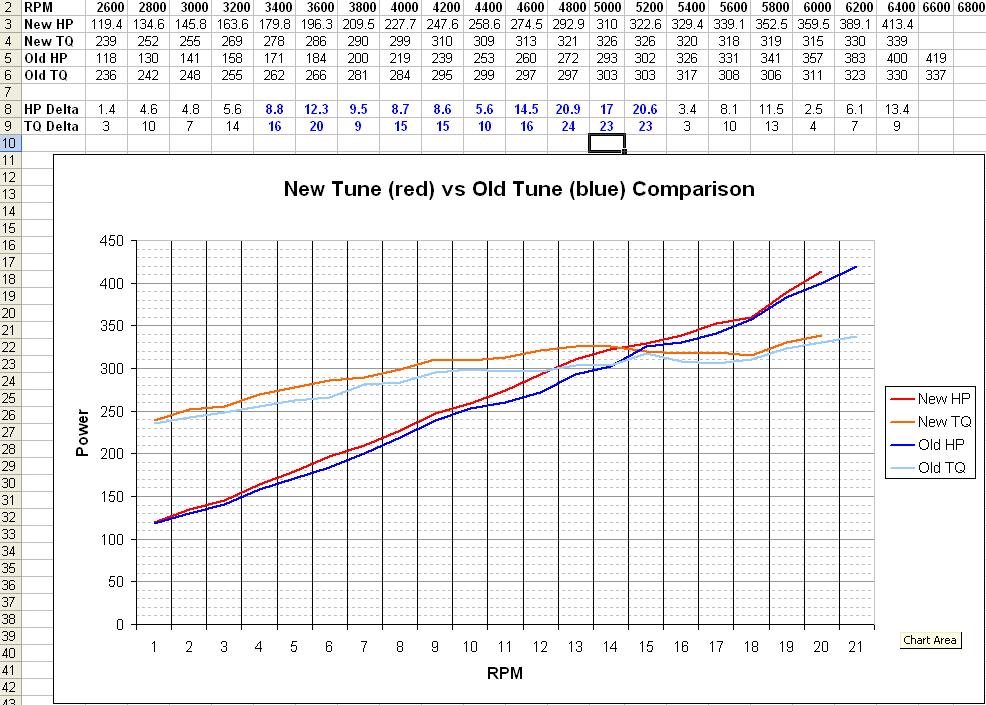

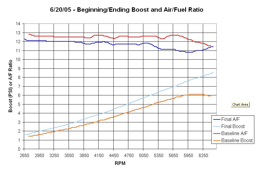

For the record, I'm now turning roughly 420rwhp on a conservative tune using the SSV and a 3.12" pulley. My question is this... how much power gain are people typically seeing out of the pulley swap?
If the average stock pulley with bolt on mods makes 370-380rwhp, what does the 3.12" pulley with bolt on mods typically make? 40, 50 more hp?
For reference, here are my dyno comparisons (graph 1). We started the day on the old tune... my car was only making 340rwhp! So, the question is can a good tune and a pulley swap wholey account for a 80hp gain at peak by the end of the day?
Second graph is A/F and Boost for the same runs. The air/fuel doesn't actually rise like that at the end of the powerband now, it stays below 11.
The final graph is a comparison between my original 425rwhp run when I first had the Vortech installed. That was pre-SSV and on stock pulley and was tuned to the max. It is compared against the same run from the first graph which is with SSV and post pulley sway and tuned semi-conservatively. Peak is almost identical, but there are significant increase under the curve. Again, question is how much of that is SSV and how much is the new pulley. Keep in mind, they have another 2 or 3 degrees of timing they could take out on my car to make even more power if I wanted to live dangerously.
Not sure if all this info helps. My opinion is the SSV is better than upper plenum replacement pieces... but not by as much as Kinetix claims. Still, if you want a great looking piece and ability to retain your stock strut bar may make it nice enough to justify the purchase even if the mild power gains over plenums do not. Just my .02
Pic
its kind hard to see the chart but it looks like from 5000rpms to 6500rpms it looks like the a/f is in the mid to low 12's..... I think you should of had thr a/f tuned with mid to low 11's in that rpm range to have a really safe tune

actually I was looking at the red line... I think the blue is your current tune right? if it is why is it so rich?
Old Jun 22, 2005 | 06:36 AM
G352NV's Avatar
G352NV
Posts: 2,141
From: Sac
In that section its 11.5, thats the highest it got to.
Andy, the 81whp gain wasnt all a result of your mods, such as the pulley swap and plenum. The baseline dyno was very "out of tune". Mid 10's on the A/F only only 10 degrees of total advance. That is the reason that car made only 340whp.
If AF was simply optimized, and additional, but safe timing added back in, your car would have dynoed about 380-400whp easily with your current mods. Now the pulley swap comes into play, and adds 2psi or so, and an additional 20whp or so.
It's too hard to say what portion of the gains came from the plenum, vs. the pulley. But I can say with certainty, that just optimizing the tune is really the cause of your newfound power gains. Hope are you are enjoying it.
