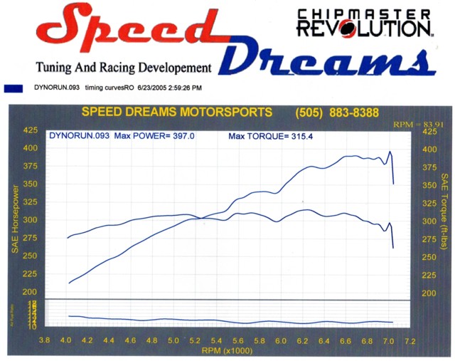

Here are my new numbers thanks to a good tune by Ryan at Speed Dreams!
Attached Thumbnails Kinetix SSV, pretty much a show piece.-dyno-05-397whp.jpg
